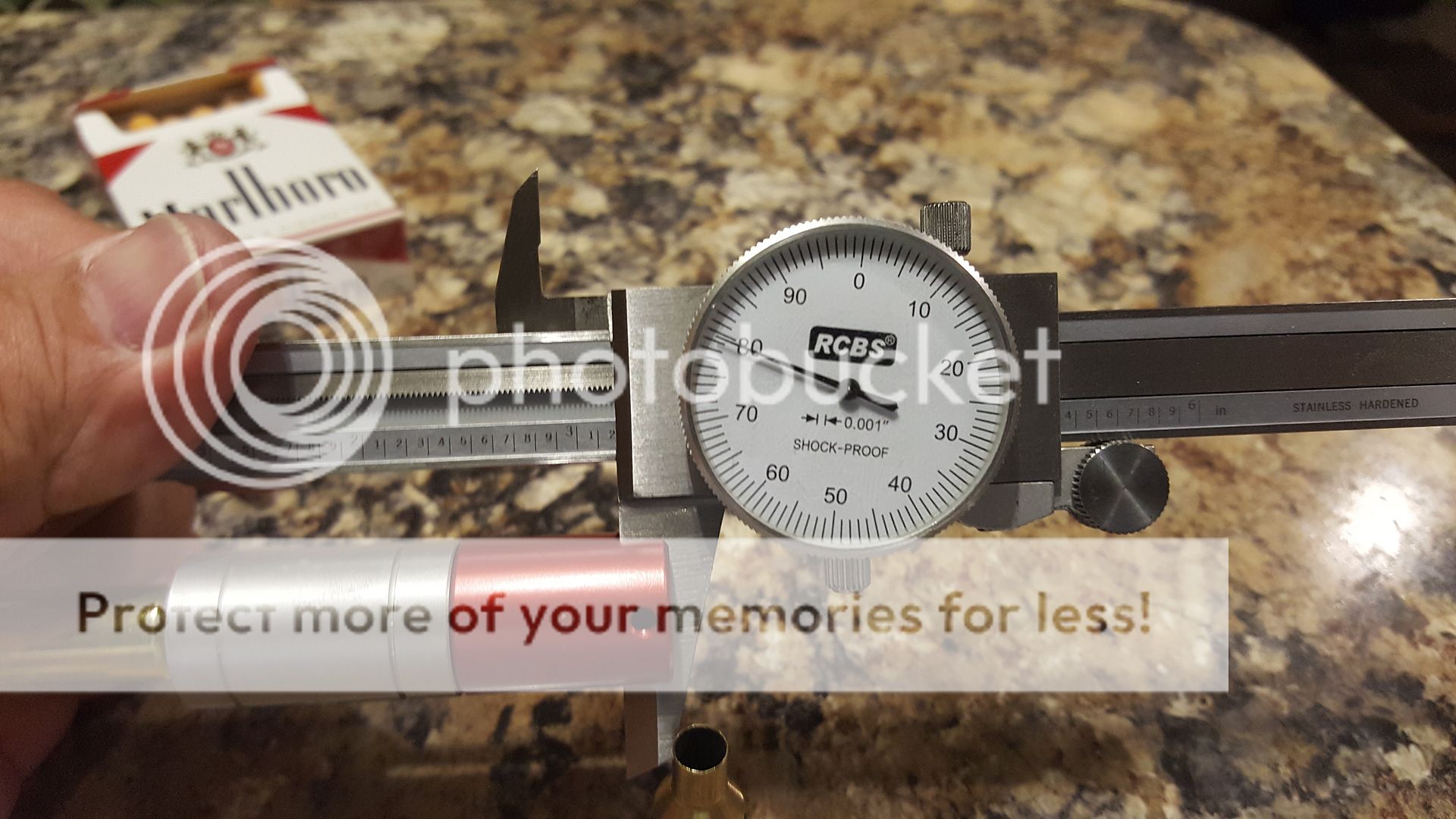

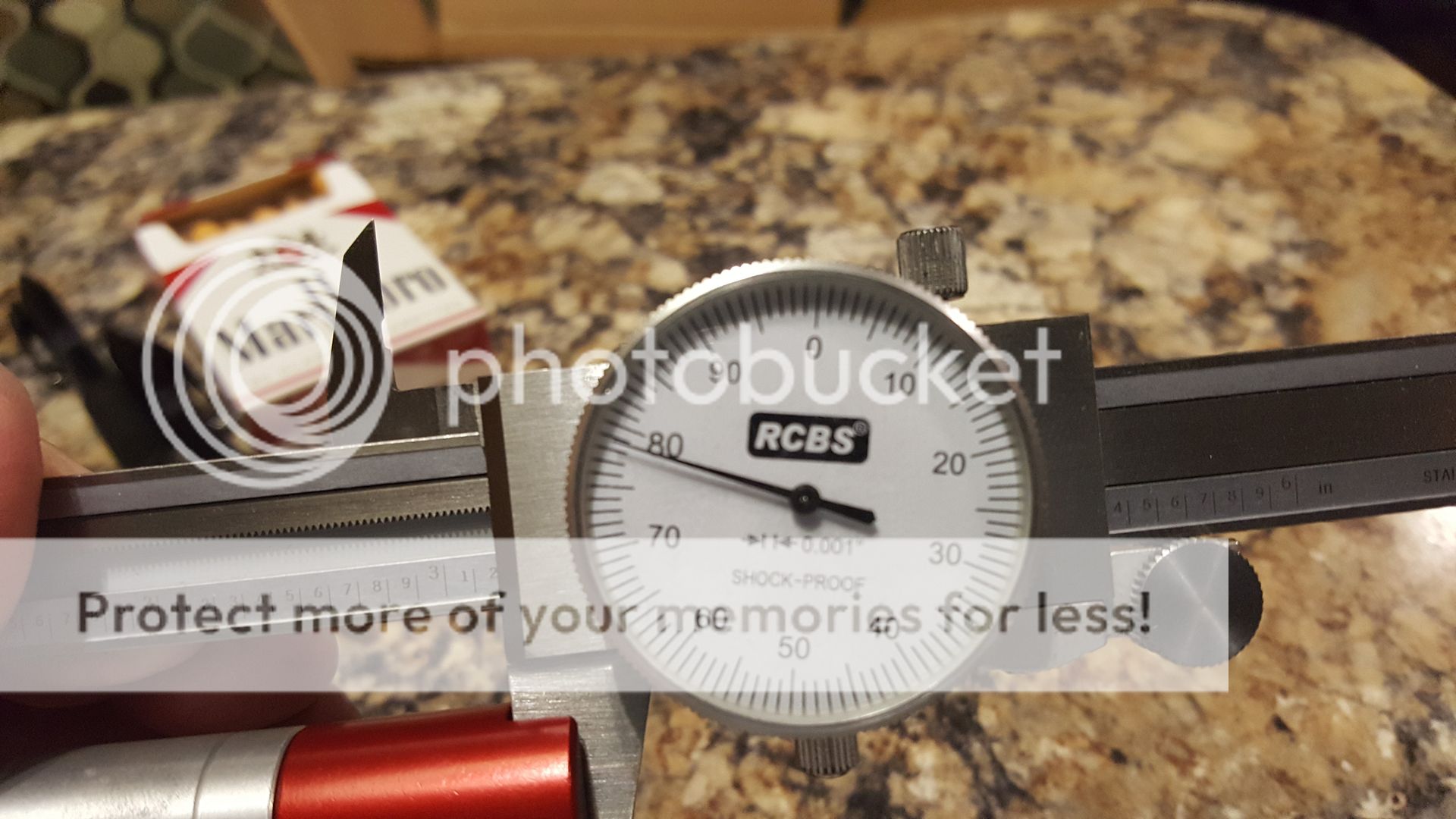

Well look at the pics below. Fired brass and sized brass from my 6BR. I anneal every 3 to 5 firings. My fired brass, all of the 50 rounds, have the same measurement and all the sized brass has the same measurement. Doesn't matter if it is freshly annealed or the 5th firing.
The two cases I see have .001 differences between . Larry
