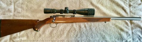

When you like something and it works very well for you, just about everything's "special". This one has been special to me for at least 25yrs.. A Ruger 77/22M that was only acceptably accurate, nothing special. Got a Lothar Walther 10/22 barrel ( tighter bore, regular stainless), had a 22M reamer done spec'd for Win. silverbox JHP. Very good local 'smith threaded the action and barrelled it. Another local gave it a 12oz trigger, very nice. And it shoots quite well, as well as I could ask of a 22M. It goes on every outing. It now wears a 3-16 Sightron S-Tac

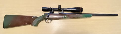

This one is a true junkyard dog, gunshow special. Sako 461 action from an A&M 17-something pencil barrel, very severe failure. Bent (long) extractor and bulged magazine plate....not difficult to fix and action was otherwise fine. What had been a very pretty stock was cracked and broken here and there. The very skinny barrel was toast. Action fixed, gunshow .222 Apex barrel cut to 23", chambered .221 /.250 nk / 0 fb. Now has a crummy Sako varmint stock, $30 from Gun List. Painted and still ugly. Built in late 80's and still very accurate, has dispatched a huge number of varmints. It now wears a 4-20x50 Athlon Heras scope. Not pretty, but special to me.

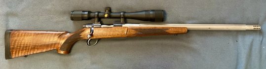

Next door is the replacement. Another gunshow special. Sako A1 action w.461 bolt. Had 17 barrel with screwed up chamber, but the nicest Sako stock I've ever seen. Now with Hart barrel, cut to 24", rechambered .221 with my reamer. Came with the brake, I can't get it off. A dream to shoot and extremely accurate. Now has an Arken 6-24 EPL.

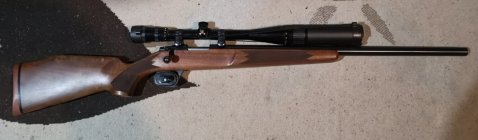

Here is on of my “squirrel rifles” it started as a R700 varmint special in 222, that was new to me in the early 90’s. I restocked it with a used Mcmillan HBR stock that has worked great from out custom made pivot benches
I wore it out with AA 2015 and 50 grain TNT’s, rebarreled with a LV contour shilen in 222 and shot another 7500-8000 rounds from that barrel. The barrel was toasty and my batch of brass was also done.
I went with a Bartlein 12 twist in 221 FB on it this time. I still have some 50 grain TNT’s left and they shoot .5 MOA so I will be shooting it with those on the next trip.
