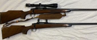

Top would be a skip line and bottom would be a solid?

I know that I should let mine “make music” but it’s still unfired and It’s so pretty(compared to some modern rifles) I get the shakes when I think about it. LOL
I don’t know when it was made but the checkering looks more like cut checkering. I took it as a trade and I have other varmint rifles so no hurry, I guess.
