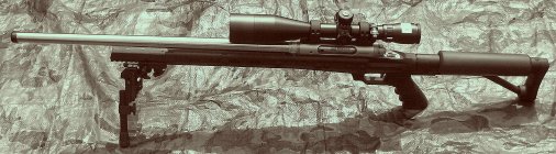

Custom
20-221AI kreiger #3 -1-11” x 22” finished
Stevens Accuracy chambered
Sauter ordered/ recommended the Valdada SFP Spyder scope
Cooper M21 action- FP ignition reworked
Jard trigger massaged
B&C stock- pillars installed, action fully bedded
Area 416 arca rail 4” for tripod use
Treaded 5/8”x24tpi for suppressors & a brake
I have the complete reamer set for making dies & barrel chambers
I also made a action wrench for it, & a bolt holding fixture
Slings 32gr pills @ 4012fps, longest kill so far-587yds- groundhog
-rang steel @ 800yds..impact !!View attachment 1625377View attachment 1625378View attachment 1625379View attachment 1625380View attachment 1625381
It’s not to look- it’s to use… every day if possible!!
