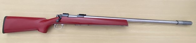

Looks familiar..............my 40X / 22BR
