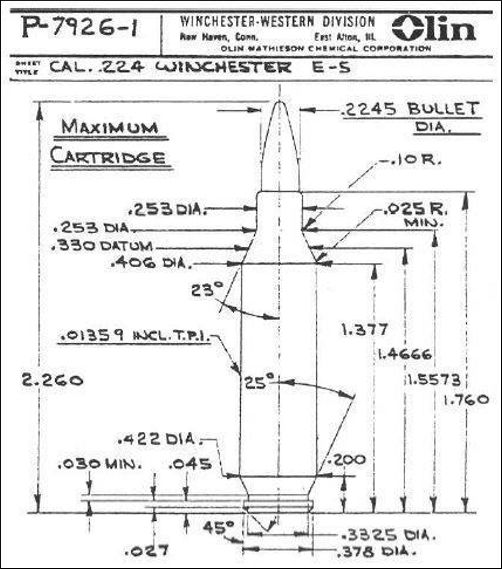

Here are the apparent specs for the Win. 224E on post # 12 on the link below. It is extremely similar to the 22 Nosler, but there are some slight differences such as shoulder angle and head-to-base of neck:
Loaded ctg OAL- 2.260
Case length- 1.760
Head-.378
Base (.200 from head/rim) - .422
Head to shoulder- 1.377
Shoulder angle- 23 degrees
Shoulder dia- .406
Head to base of neck- 1.5573
Neck dia- .253

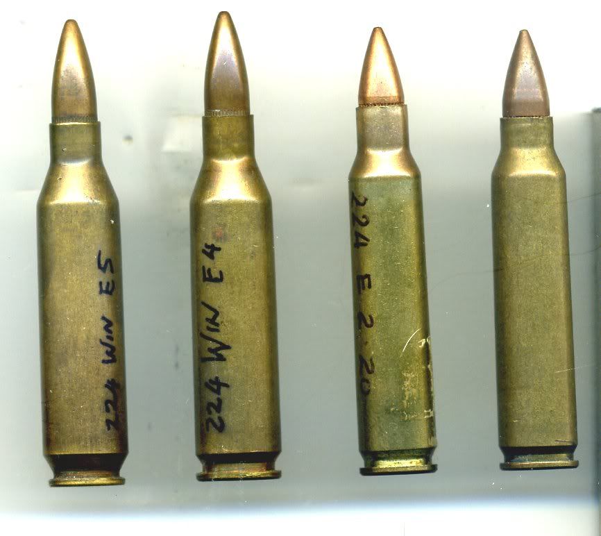

Here is the photo of the .224 Winchester E5:
And here is the drawing for the .224 Winchester E5:
