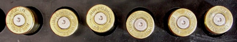

I have since back off that 50 gr load with 190-gr sierra MK.
After more testing I found it a little to hot, so im back to 48.5 grs as my new max load for 190-gr sierra MK @ FPS 2713.
Funny how that on the first 50gr load testing I hadn�t experienced any stiff bolt lift or flatten primers. Not so on this testing though.
Subtle? Man, then what I use as telltales must be downright insignificant!
What with the L and almost half the A of Lapua completely smeared away and a solid imprint of the extractor cut on the bolt head I'd have to agree those are SUBTLE pressure indications... not to mention the black deposits surrounding that primer.
I'm surprised that case still HAS a primer in it! I'm guessing it's toast....
This is the exact same load the previous week, only mild pressure signs... if you look closely from left to right the second round has only a light ejector mark and the primer still looks ok.
Yep, I agree. Head #2 is about what I look for when I'm working up loads & watching for pressure. All those primers still show some radius too, none show evidence of gas leakage....
2700+ with a 190 ought to be "good enough" I trust. I know shooters who run 175's at that & do quite well.

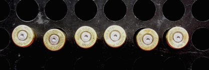

The best powder combo I've found with 155.5 Bergers is 8208 XBR. My Pierce with 26" Bartlein provides 2990, no pressure indication and accuracy that occasionally startles me. Last week, I fired a .688 5-shot, prone from the bipod at 300. The group was two ovals and one slightly below.
So far, only the 210 BT-LR has given me very good results with RL17. 30" barrel is at 2620 and low ES/SD figures. This past weekend we fired a 5X1000 at Camp Pendleton. An F-Open guy commented that he had never seen a .308 hold 1000 yard waterline like that and we had an 8-12 mph headwind. When the combination is correct, RL17 does perform. Some folks have commented negatively about temperature sensitivity but we went from 45°f at 0800 to 75°f at noon and my 1000 POI did not change more than the wind would account. Examining the fired cases (shot in order), I saw no indications that pressure was rising with temperature. I shot first relay in the morning and twice more, third match around 1300.
