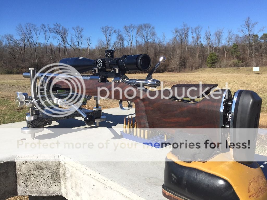

Spear of Destiny .284
Speedy SOP in Dark Walnut with all options
Straight 284 - .320 neck with .215 free bore
Bat M, Right, Right, Left eject
1-Kreiger 1:8:5
1-Kreiger 1:8
1-Brux 1:8:5
Bix-n-Andy Trigger
Nightforce Comp on NF rings
Stevens Accuracy did the metal work and Speedy/Tommy Shurley did the stock work. Breaking barrel's in now, and it's showing a lot of promise. Still trying to make up my mind whether to hit it with another coat of tung oil and leave satin, or put a clear over it. I was torn on whether to install the RAD system, but after shooting it, I know that I made that right decision now. It was well worth the extra money.

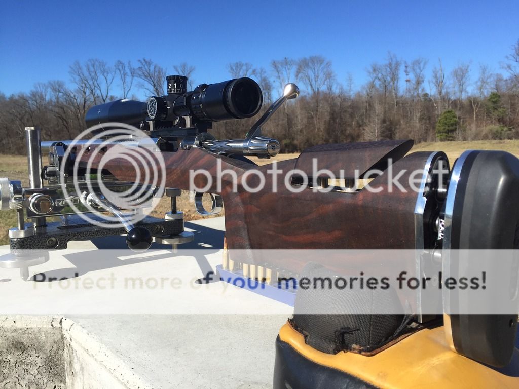

1-Kreiger 1:8:5
1-Kreiger 1:8
1-Brux 1:8:5
Bix-n-Andy Trigger
That is a beautiful piece of work
First step is to rob a bank :)...then give Speedy or Tommy at Shurley Brothers a call. I can't say enough about how great they are to deal with.
Sweet Jimmy ! I love fine wood. Don't spray that stock, rub it.
The old school for satin finish (coats)
Once a day for a week
Once a week for a month
Once a month for a year
Once a year for life
Once you go wood Jimmy, you will never see another pretty stock unless it's wood!
Stock is a Speed Spear of Destiny, made by Shurley Brothers and Speedy. Contact Tommy at Shurely brothers or Speedy and they will set you up. In the gun industry, very quick turn around times as well.
