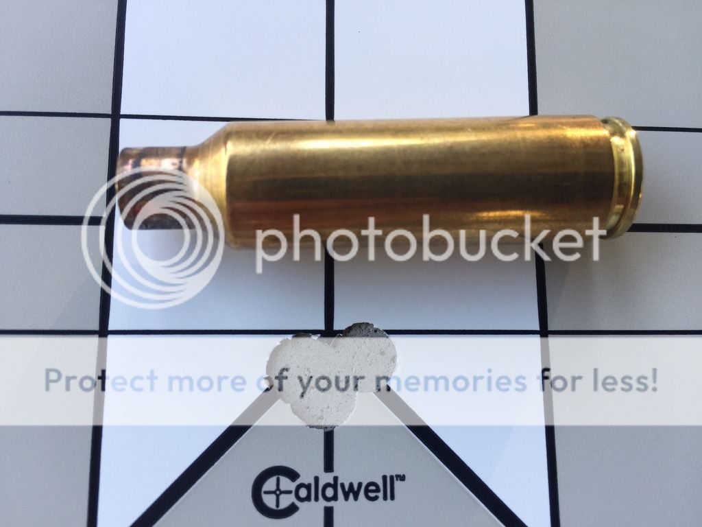

100 yards
100 yards

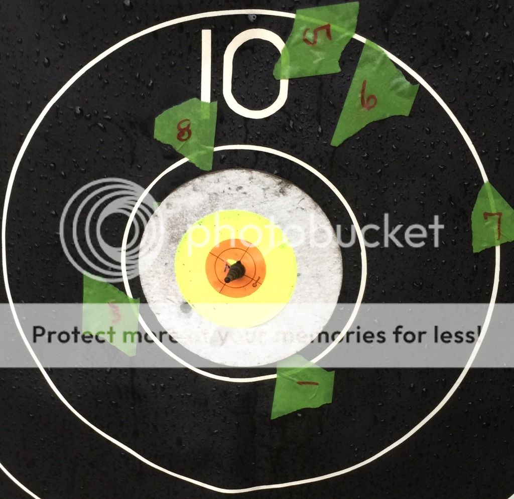

640 yards(in a torrential downpour with lightning for good measure)
