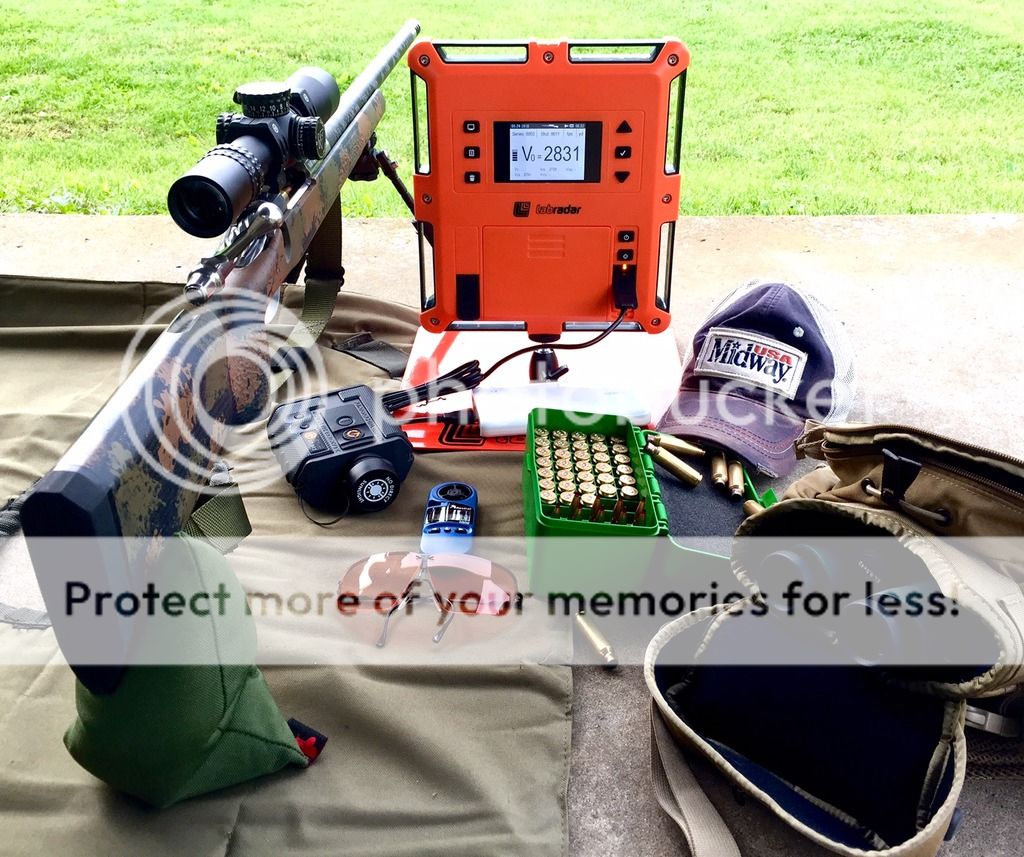

Are hunting rifles welcome in this thread?
300 WSM: Norma Brass, 200 Hornady ELD-X, 68.5 grains H4831SC, BR2 Primer, 3.125" COAL
Defiance Deviant UL XM length
Proof Research 24" Sendero w/ Badger Ordnance Brake
Jewell Trigger
Manners EH1 Stock
Nightforce ATACR F1 4-16x 42mm, American Rifle Company Rings
Wow, love that 300wsm. Do you find the defiance actions worth the extra over a stiller? Any shooting results from it worth sharing yet?

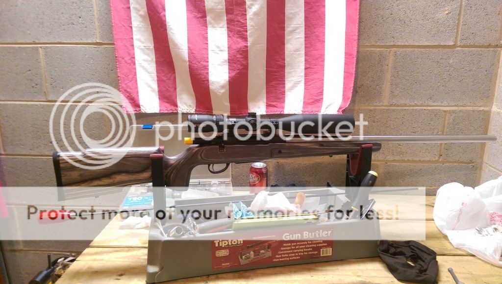

I've got this .308 tikka T3 with a brux done a little while ago.

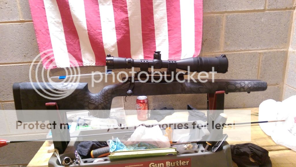

Here's my latest addition, McMillan a-5 with a real nice 700 LA. But I honestly don't know what I want to make it into :confused:;)
Thanks! I don't own any Stiller actions, so I can't say how they compare. The XM action is specifically designed for the WSM length cartridges, and the Deviant Ultralight has a built in, split 20 MOA base. I thought that was a pretty slick design, so I spoke to them about it when I ordered the action. Mike at Defiance was great to deal with and walked me through all of the numerous options.
