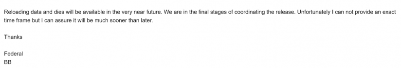

I contacted federal, they told me the reloading component is in the final stage to be released, which is a good news. what do you think? Anther concern is, even if they can be reloaded, with the higher case pressure, is it tunable like the brass case cartridge?
