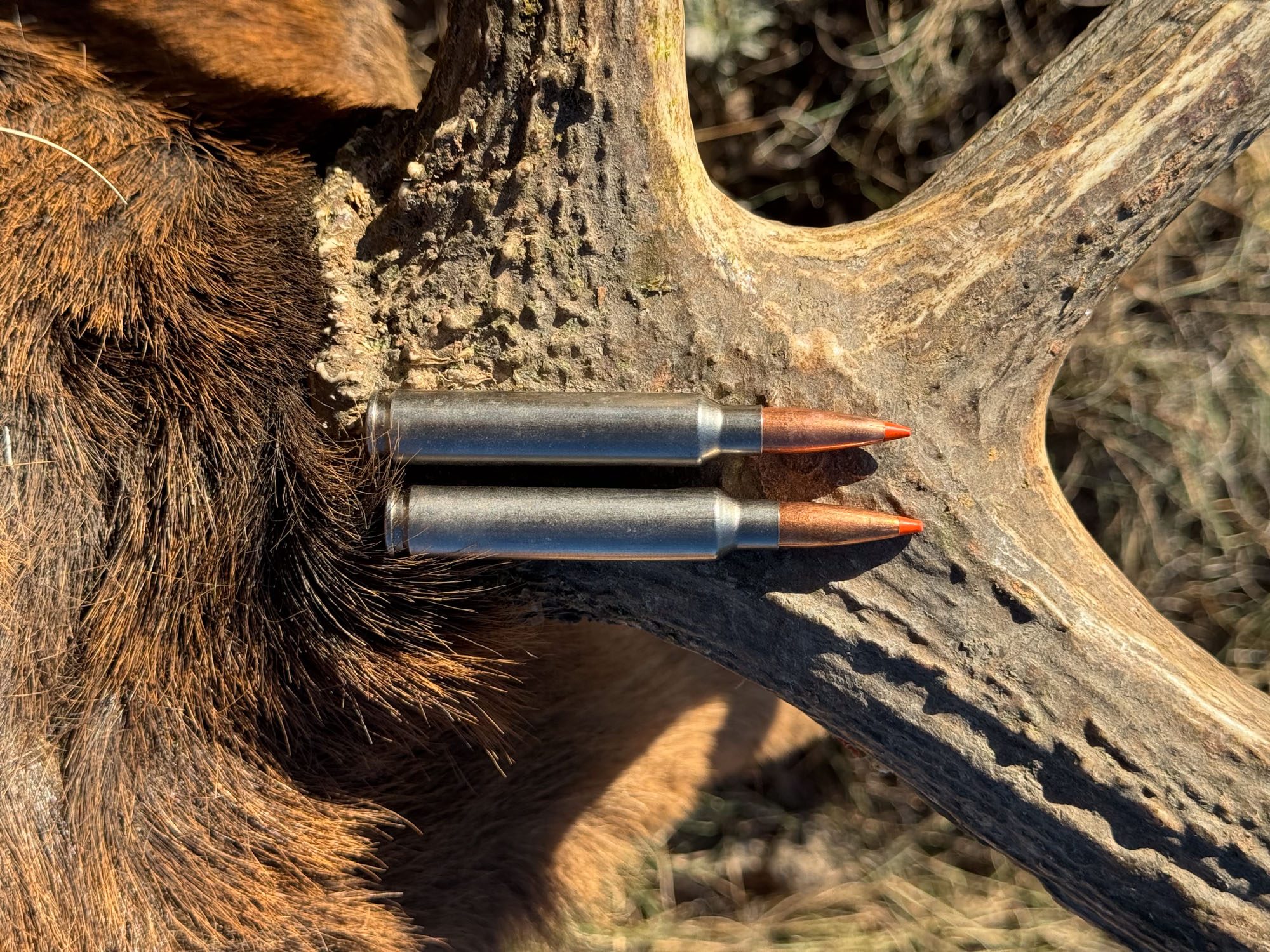

Federal has released a new cartridge that looks suspiciously similar to the .280 AI, but outperforms 7mm PRC. The kicker is its a new steel alloy that will reload similar to brass, but handle an operating pressure of 80,000. Basically, it makes a 175 gr bullet run 3175 in a 20" barrel.
Is this the future of ammo?
