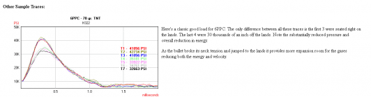

If you ever shot thru a test barrel youd see the pressure change of the changing case volume. That may give you more of an idea of how and why it changes

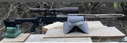

300WSM, 220 Matchkings, Benchmark barrel, factory trigger, Vortex 6-36.
Shot 3x3 shot .008 stepped seating test. Then the best one back to back here.
19 shots into a new bullet.
Depth tuning makes your first bullet hole your target. Never had so much fun never being happy.

Seating depth would change
1) Effective case capacity
2) Time between initial ignition and time when the bullet engages the rifling
3) Initial bullet speed when said bullet engages the rifling
4) Initial case pressure rise and peak pressure
5) Bullet barrel time +/- time in 2)
