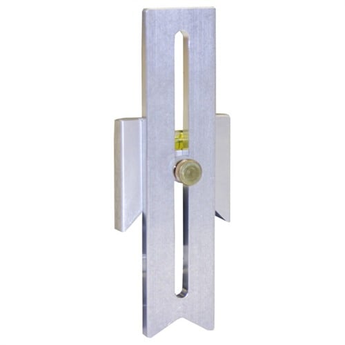

The top of the turret is not always level. The way I think of this is the vertical crosshair should be in line with the bore of the barrel. I first line up the vertical crosshair with a plumb line at 100 yards and attach a scope level to the tube and center the bubble when the vertical crosshair is plumb. Then I use the following tool to get the center of the scope in line with the center of the barrel.
While the center of scope is over center of barrel, rotate the scope to center the bubble level. Tighten the ring caps and you're done.
