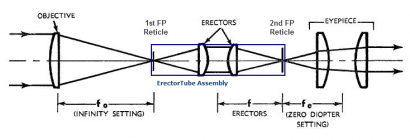

To help the discussion, here is a simplified telescopic sight optical layout:
file
As shown this is fixed power scope. It does not matter if the reticule is at the 1st focal plane or 2nd focal plane in a fixed power scope. POA hold will be dependent only on the mechanics of holding and/or returning the erector tube to its set POA.

Note that the quality of the zoom system employed will determine how close it is to being Parfocal,maintains focus at at all zoom settings). If the reticule is at the 2nd focal plane, any error in focus with zoom setting will introduce the potential for parallax error at that setting. Also, since there are several lens elements located by cams all of which require some clearance to move, there is further potential for POA shift between shots. Therefore in a variable it would be better to use a 1st focal plane reticule location to improve the probability for holding POA.
The reticule will magnified along with the target in a variable power scope using a 1st focal plane reticule. Therefore it is usually best to select a reticule that has very fine cross hairs and/or very small dot at least at the center for precise aiming.

Very informative Fred,Thanks. I never looked at the differences that way,as far as the mechanics play was concerned)
