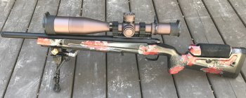

The New Vortex Razor III 6-36x56 has 36 mils or 120 MOA of elevation and better glass than the Gen II so if I could do it with the Gen II the Gen III would be worth a look for someone wanting to try and wanting to stay below the $3K mark. I just got a Gen III and it's on my .22 now but will be getting another for my centerfire soon enough.
Plain 'ol Nightforce NSX 5.5-22x50 will easily get you to over a mile. No need for FFP......
They have 100 minutes of adjustment, paired with a 40 MOA base and you're golden to 2K or better, depending on cartridge/bullet.
Here's a setup at 1800 plus:
And you can still quarter a milk jug:
