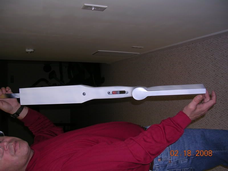

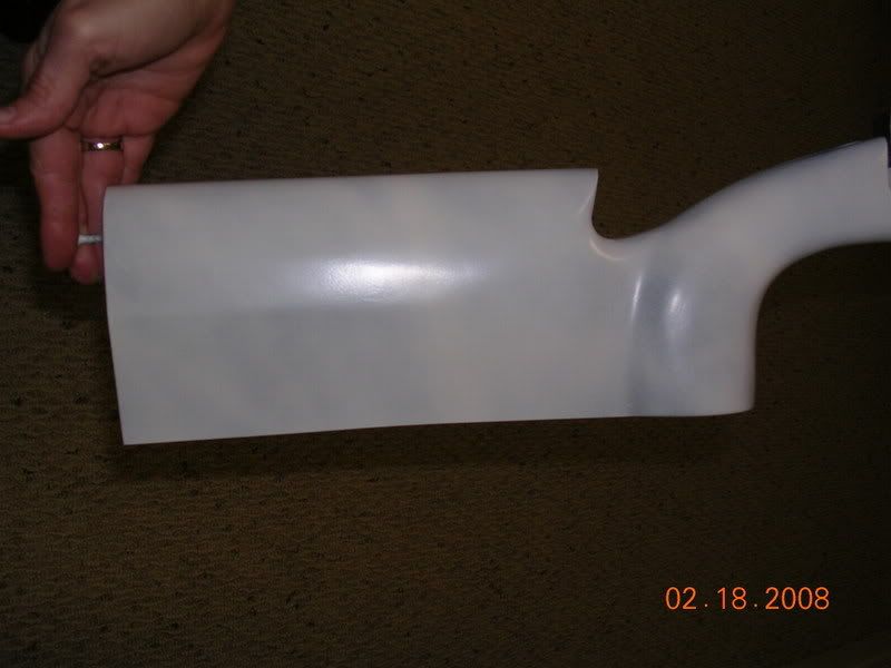

You mean like this? To make the toe parrallel with the front of the stock and grip?

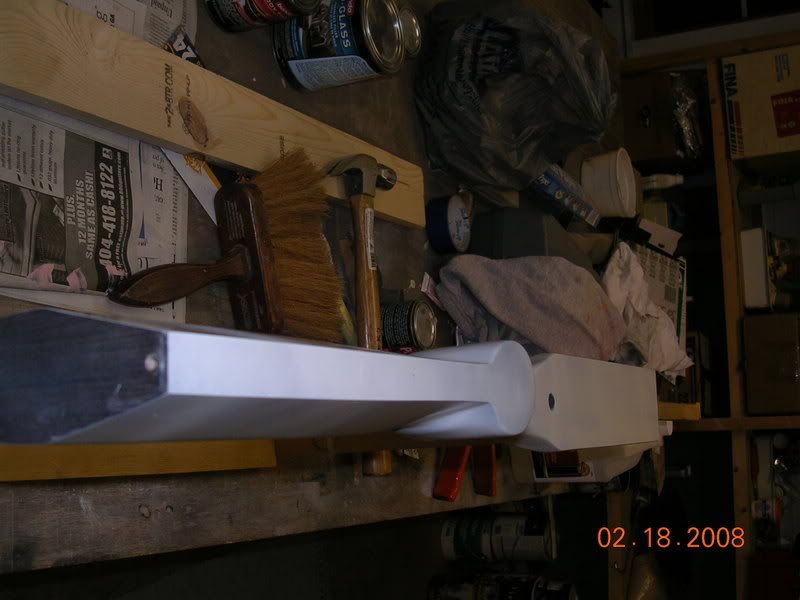

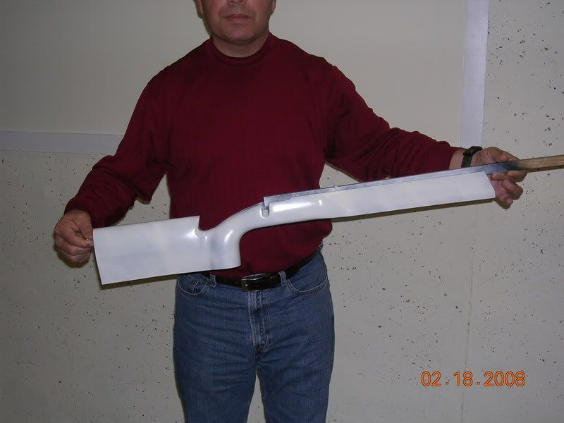

Yes, it can be done pretty easily. On this one, I cut the toe off parrallel with the bottom of the grip, then inletted a piece of 5/8" aluminum bar stock into the grip and screwed it down fore and aft with brass screws. Filled up the gap with PC-7 epoxy, rough sanded then finished with automotive filler. The barstock serves as a sanding guide to get the stock sanded into a smooth constant angle where the bags will ride, from base to grip notch. The base stock for this is a wood Savage stock. Did alot of other mods to it as well, including adding a wide fore-end.

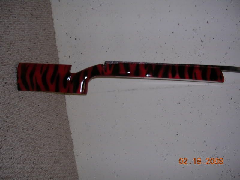

Completed stock after mods and paint.
Beautiful job! What kind of epoxy is pc 7? I never heard of that one. I do some woodworking as a hobby, cabinets and tables and stuff but never tried to do a gun stock. What model savage is the stock?

PC-7 is a 2 part epoxy sold at Ace Hardware. The display had a nickel and some screws stuck to a coke bottle, so I figured it would stick anything to anything. It's good for filling, makes into a thick paste, dries pretty quickly, relatively cheap, but makes a poor sanding surface. You'll have to finish off surface with auto body filler.
The stock started out as a standard BVSS stock. I laid the whole thing out on my work bench on some butcher paper, drew out the lines to get the surfaces parrallel, then made the cuts with a table saw. Slightly rounded fore-end - I epoxied on some wood dowels on the edges to get the width I wanted, then filled up the "gaps" with PC-7. The wood dowels made a decent sanding guide.
A hint, you can use the wax surface of butcher paper as a release surface - clamp the stock to the table, lay epoxy on the surface you want to glue and the epoxy will stick to the glue surface but not to the wax paper. Makes a nice even surface ans eliminates alot of sanding. You can also let it harden half way, oil up a pencil and roll it over teh surface to "nead" it into place. The hardest part to do was blending the wide surface of the fore-end to the stock in the middle - that took some trial and error with auto body filler.
I did the fore-end first, then cut/filled the toe of the toe of the stock, then reshaped the grip grooves with a dremel sanding wheel.

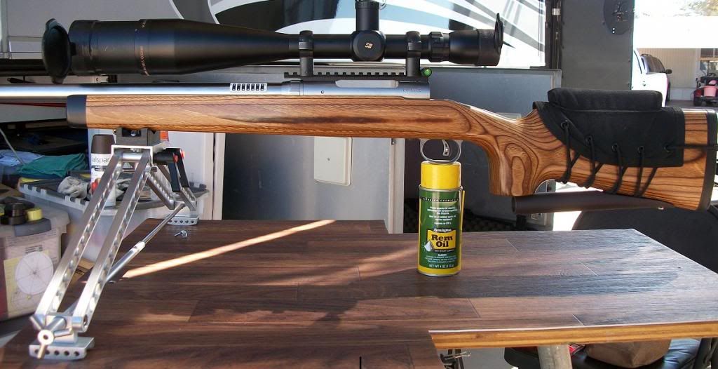

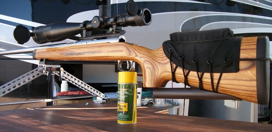

Here is my attempt at converting my 12 BVSS stock to a benchrest style. I used the RemOil can to support the gun at the trigger guard so the entire 'project' could be seen. (Sorry for all the clutter in the background.) One screw where the sling stud was is all that is holding it in place.
I will be trying it out tomorrow at the Usery Mtn range. If it works as well as I'm hoping, I may get ambitious and try to copy Elkbane's masterpiece. I've never worked with body filler, so that part is a little scary.
Looks good. Looks like what I am planning on doing, except mine will be wood, and screwed and epoxied to the stock. Body filler is easy to work with but honestly I dont see the point for your design. Id keep it the way it is.
