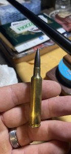

Well it's a little nasty here, cold and been windy, but this afternoon the wind was tolerable so I took the opportunity to sight in the rifle, and check some loads for pressure. I had fired 2 shots and cleaned twice wed. and thur. So I had 4 cases formed. I decided to load one 1/2 grain over the Sierra book max, One at 1 grain over, and the las two at 1.5 grain over their listed Max. Sadly my Chronograph took hard hit in the back of the truck and was not working.
But three shots, and I was sighted in dead center at 100 yards, using 55.0 grains of H4831. I had 8 rounds, I rarely am not sighted in with 3 shots, and wanted to see what 5 shots of the fireforming load would do. I screwed up and shot the second shot out of those five at the wrong bull, but it shot same place on that target the other 4 did on holding same place on the record bull, about 3/4" group at 100 yards.
I took the last four 56.5 and 57.0 grains with the bibs 88 grain HPBT's loaded to barely touch the lands at the S emblem on the BR target with the 5 fireform shots, those two were just slightly over 1/2" apart. But then I had the 2 I loaded with 57.5 grains at a separate S on the opposite target I had hung. I was pretty happy. I am a realist and know that 2 shots from any gun don't mean anything, but it gives me hope knowing they were only .258" center to center just touching.
This where aI will start mynsearch for a load for this bullet. I now have 12 cases, so I will load 4 each with 57.5 grains, 58.0 and 58.5 of H4831 for my next trip next week to the range. I will also load the rest up and for fireforming, and get another 20 or 30 rounds fire formed. It is forming to perfection but I think I will switch to H4350 and the Nosler 85 BT's for the rest of these 50 cases. But man I need the chronograph to know anything about how consistent this load is. At long range ES is critical as we all know. Paper don't show that.
16 shots on this barrel now and after cleaning it from these 12 shots, I had very slight traces of copper that cleaned up with butches, and nothing more with about 6 wet patches. I then brushed, swabbed and dried the barrel. I always use a few drops of TSI 301 on a swab to treat the bore and leave it. I usually have a same POI on the first shot as the rest, or close enough for a good first shot hunting.
I'll report back when I get the first real test loads on paper next week. Hopefully I'll get my chrony working by then or at least find one that works to borrow.

I got out today for the second time. Not exactly ready yet to load the fireformed cases, but I was able to try the first load using H4350 with the 88 grn. Bib Bullet, but the speed was a real surprise. No heavy bolt lift, and no head swelling on the brass. But I can't stress how tough this 8x57 Lapua brass is! I also bushed the bolt and am running the smaller dia firing pin, so no cratering with this load. It also showed less Extreme Spread than the H-4831 did @ just 25.4fps for the 3 shot group.
I now have a load to start with, this will be where i begin, and I'll see what .5 and 1 grain more both do. Then I'll start a seating depth test. right now I'm .005" in the lands. Even if this would be a freak and the best this bullet and powder will do, I'll take it. The 3 shots are in the mid .3's @ .376". with the average 3747 fps thats minute of ground hog at 800 yards. Hoping to cut that by .1" for 5 shot groups, anything around 1/4" at this speed is better than I had hoped for.
The other thing I will work with is, neck tension. Right now the Forester FL sizing die is all I have to get enough tension to hold a bullet. I have .287 bushing but with a .287" loaded neck dia. I am not able to use that, the .283" and 284" bushings will be here tomorrow. So these were loaded by FL sizing which leaves the neck at .279, way to tight for seating. So I then ran them thru the K&M Neck Mandrel to expand for turning. So I have barley got .001" neck tension, my thinking is very weak for this cartridge and powder.
I'll know soon, but will have this option. But now will try my original plan with the Redding body die for bumping the shoulder, and then the wilson bushing die for determining the neck tension. I think better days are ahead once I get all my dies in order.Starting cold with new everything takes time, but results like this, tell me it is worth it!
