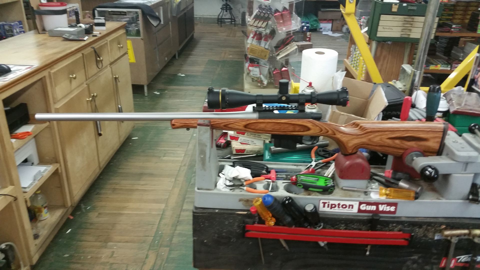

Have a 6x45 on a Rem/AAC action with PTG bottom metal with AR magazine. Sendero profile X caliber barrel and a laminated factory M7 stock that's free floated and bedded. Modified a 10 rounder with a single feed follower and then regular 10 shot mag. It gives me options:rolleyes: Not nimble or light but well balanced and shoots great. Don't mind the action screws, torque them and go.
