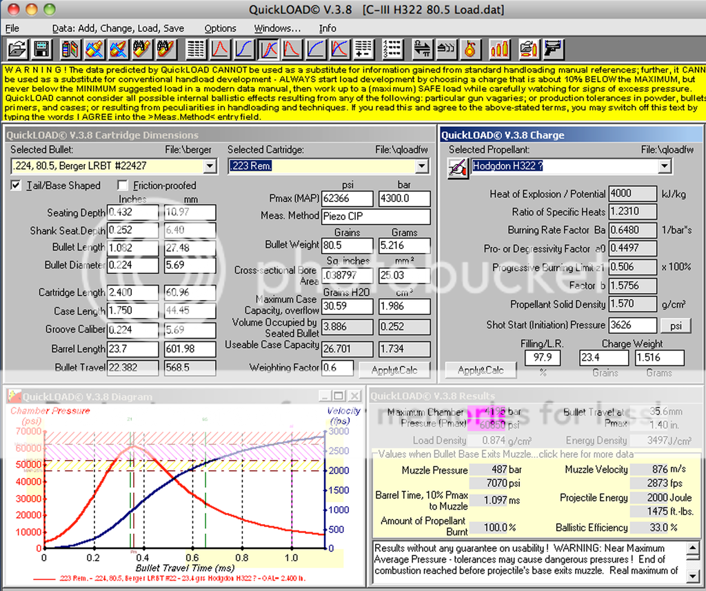

With your setup, I think you should be able to hit Node 4 (~1.090 ms for a 23.75" barrel). However, I would suggest using Hodgdon 322 instead of Varget for a couple reasons. First, H322 has very small kernels compared to Varget, which are easier to measure precisely and consistently for a small case like the .223 Rem. Second, Varget is going to be fairly slow in your setup, especially with the relatively short barrel. A slightly faster powder like H322 will help get that 80.5 gr bullet moving in the shorter pipe.

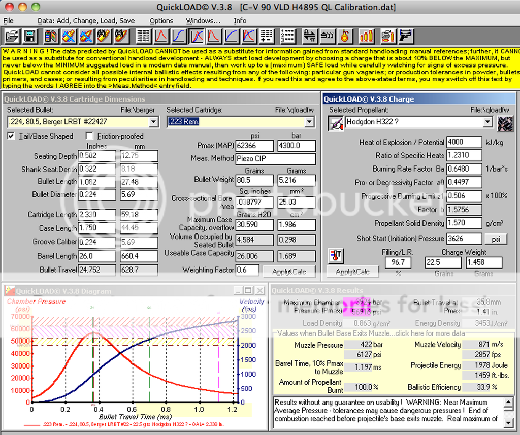

QL parameters: barrel = 26.0", brass length = 1.750", bullet OAL = 1.082", case volume = 30.59 gr, temp = 70 degrees F, COAL = 2.330" (CBTO = 1.851", ~ .018" off the lands). Output below:

I did look at Node 4 – with my adjusted QL, node 4 at 1.09 ms required 25.4 grains of Varget with predicted MV of 2,896 fps. Pressure was 62.127 psi which is over max which is the only reason I did not go there. Perhaps the difference is in our barrel length?

You're right about the barrel length, I should've checked that the first time. Your 23.75 is a tic short and to hit Node 4 with that barrel and H322 would require about 23.4 gr and run at almost 61K psi. That's a very stout load and brass life would not be great, maybe only one or two firings. In my hands with the 90 VLDs and a 30" barrel (Lapua brass), when the QL predicted pressure gets up to about 58K psi, brass life goes south very quickly. If you use some other brand of brass with greater case volume than Lapua it would help, similar to having a longer freebore, but I suspect it still wouldn't be enough to get the pressure down to the 55-56K psi range. I ran my H322 load file with a 23.7" barrel length and 2.400" COAL values and got the following prediction for Node 4:
