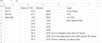

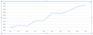

Here are my results of the pressure test with TAC. I had the very slightly primer cratering at Hornaday max load, nothing to worry about. I can feel it with my finger but barely see it. 26.1 is obvious primer craterering. I see zero other signs, probably cuz its 556 brass. I bet it could go higher with a different primer, but 26.1 with the CCI 400 is too spicy for me. Where would ya'll go with the powder test now? I'm thinking 25 to 25.8 in .2 grain increments.
I left the ammo outside in the shade for over about 2 hours first. It was only 91. It was 97 last time on the dog town, ammo cooking in the truck. I dont want to even be close to pressure with ball powder.

Where would ya'll go with the powder test now? I'm thinking 25 to 25.8 in .02 grain increments.
I would run group tests at 25.4 and call it good if they perform, but I'm the type who likes minute of prairie dog at about 400 yards with these and calls it a day.
Did you slip a decimal in the 0.02 grain increment or is that really how small you plan to step? YMMV
ETA: The temps were in the 90's for your test. The reason I mentioned the REM 7 1/2 is for even hotter and much colder days. Nothing wrong with the CCI 400 or these results.

Yeah that was a typo, .2 gr steps. I hear you on just picking one and see if it shoots. If I was to guess like that I would go with 25 as its a flat spot and nice even number. 25.5 would be my next choice. Might be a good choice since its not even my rifle. If his shoots .75 moa and mine does .5 moa, more chance he buys the beer lol!

I like these at right around the published max if the powder is stable in heat, so if we said 3250 plus or minus, and we say for example on varmints we want at least a 2000 fps impact, then these would be good for around say 350 yards or so. After that, they still work but there is less splat factor if you catch my drift.
Here is an AB run for you with a sea level condition and 9 twist assumption. I think TAC will do just fine.
But BTW, there is no such thing as the "flat spot" you mentioned. If you ran that identical test a few more runs, it would evaporate and the whole plot just looks like a smooth line with a thickness. Trust the targets, and try not to focus on the chrono and flat spots. Good Luck and in for the range reports.

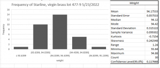

What I will show is some data I have for both Fiocchi brass and Starline.
The Fiocchi is once fired from their varmint ammo with the 40 VMax. It was cleaned and not resized so this is just weight and not water capacity to keep it fair.
The Starline is virgin and fairly recent.
FWIW: The Fiocchi is 98.6 grains, the Starline is 94.2 grains. YMMV

I have starline 556 weights for I think 500 pieces. I will post that later.
Hornady said that they found case weight has little correlation to case capacity. Almost all weight variance is in the extractor cut on the case. That seems to agree with either jack neary or lou murdica. I can't remember which one. They said they don't sort, because you don't know where in the case the weight difference is.

If someone were to stop with just the ones toward the upper left, and leave out the ones on the lower right, I can see where that might cause confusion. But LVLAaron's data was pretty good and it shows the issues very well. An R^2 value of 0.924 is pretty fair correlation in most discussions. YMMV
