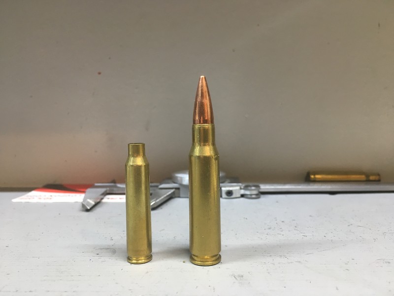

That really has no relevance in the over all question as it pertained to using a 243 bushing die . The issue is not the firearm being used but rather the size of the cartridge case it self and if it would be long enough to neck size in a 243 die . I only referenced the AR mag for a clear understanding of the length of the cartridge it self . The ARC will fit in a AR-15 mag at 2.260 , while a 243 will only fit in a AR-10 mag 2.710
This is a 223 and 308 sitting next to each other . The trim length on a 223 is 1.750 and the ARC I think is 1.500-ish so much shorter then even a 223 case while the 243 trim length is 2.035 . Note that the 6mmARC case neck will not sit as high as the 308 neck which is about the same height as a 243 cartridge . Meaning the 6mmARC case will not reach the bushing in a 243 die . Even if it did it would only size a very small portion of the neck which would result in very little bullet hold .
