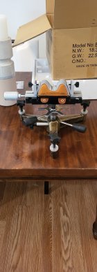

BE sells a front bag that fits perfectly and works fine. Google BR rest modification to learn how to remove the windage cable and attach the knob directly onto the head for more precise operation.
Find a good used Rock BR or BE and remove the top. Then add a DR Greenlaw top and you'll be all set. A Sinclair speed screw on the rear foot would be icing on the cake. Never much cared for joystick models.
