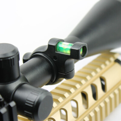

I like Hawkins Hybrid rings for my hunting rifles with dial turrets, they come with 25 MOA built in them, are light and rugged. You can get a centered level scope cap or an off set level scope cap. I’ve been using the off set cap and like it a lot. I’ve tried quite a few including NF, Hollands, mountain tactical and others all of which are good options, this is just the one I like the most. I find I can keep my cheek on the stock better and get a good view of what’s going on without breaking my cheek weld. The con is finding the darn things, you can find complete ring sets but usually you have to buh the off set level scope cap separately. Hawkins hybrid rings are popular and they don’t make a lot of them compared to other companies, if you can find them it might be worth your time, I really like them.

You do not want the bubble level integrated into the ring or on the picatinny rail of the rifle. The bubble level is to be set to gravity. So when your scope reticle is perfectly vertical to a plumb line the bubble level should be at zero. And then you set that that way and you never move it again.
How the scope is mounted to the rifle is immaterial. The only thing that matters is that the bubble level is set to gravity.

I set the gun up in a rest, level it, then install the scope so the crosshairs are level, then with a slight adjustment of the two top screws on the rear ring, I center the bubble.

The 100 yd plumb Bob is how I level scopes that are going to be dialed for long range. I level the gun on my shooting bench then the cross hairs to the string and mount the level last.
Final step is aiming at the top of my plumb line and start dialing up to verify its following it down.

I just mounted the expensive flatline ops that has flip out level and micro adjuster. Happy with it. Keep in mind that if you first level your scope reticle on a plum-bob then the accuracy of the bubble is immaterial as you will, in second step, adjust the bubble to ‘zero’ when the reticle is in line with the plum-bob. ( much easier to do with the micro adjustment feature).
If you use a ring replacement level like the Talley one, you might not be able clamp the ring down with the bubble being zeroed if your hold has a bit of cant. Best to use ring level when indexing off the receiver instead of your hold. And then the issue/question of your bubble accuracy comes into play.
