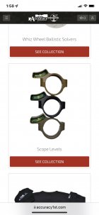

I use Holland
Tried the Accuracy 1st but didn't like it
tried USO rail mounted but it's too hard to see while you are in the scope
USO scope mounted is good
the Holland mounted forward of the side focus can be easily seen from behind the scope, smooth edges, bright and good even in low light.
