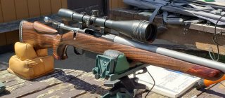

This is my Richard's microfit when it was all said and done. This is a Tikka. Inletting really was about 99%. all I had to do was open the barrel channel to my preferred size and there was a little thickness around the tang I tweaked.
As far as the shape ... You will sand sand sand. And I didn't mind that. It's fun and rewarding to watch it come together. Just realize that you are going to sand a whole heck of a lot on 80 or 100 grit to get all the machine marks (more like gouges).
I ordered grade A fancy. I was not all that pleased at first as there is little to no figure to this stock, however the color contrasting go along the grad A fancy definition. I'd probably go semi fancy next time and save some money. I was tempted to return it and demand something with figure like I expected (and their pics show) but I was antsy to start my project. 2 years later and I have no regrets.

Is that the custom rollover? I was leaning toward the old classic 102 or modern classic if I went with them.

Adam, I’ve purchased a few Richard’s stocks, but all have been walnut, mostly Claro. I would not hesitate to buy another. However, in my opinion and experience, their grading seems to be one grade step optimistic. Bear in mind that grading is not really standardized. So, their grading is different than Bishop’s from years ago, and the same would be true from another supplier. The pictures on their web site are only representative of the style and shape of the stock you will receive. As Dimner says, the inletting is pretty good. You will need to spend many hours working on the stock. You will need to invest a considerable amount of time to get what Dimner has pictured above, which I think is beautiful. If I were to buy another Claro from them, it would be a AA or AAA fancy grade, thinking that they are the best bang for the buck. Especially the AA as far as cost is concerned.
I’m not sure how you can correlate my experiences to what you want in maple, but I would definitely expect to get a stock that is one grade step up in terms of the percentage of figuring.

yes, custom rollover. I love the look for a scoped hunting rifle. I should also add that I worked at shaping extra contour to the roll over. So if you want it less pronounced, it will come that way from RMF
Total cost shipped was a little over $250. I think the results speak for themselves, you cant get anything like that from Boyd's.
On the flip side, Boyd's is where I would buy a laminated stock if I were to get a stock for a rifle that I knew I was going to put through a lot of hard use.
Checkering actually was a huge concern of mine. I REALLY wanted checkering. In the end I decided I can pony up the 300 or more dollars to have it done if necessary. So far, I'm just fine with my rifle without the checkering.
