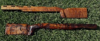

part Deaux, another rough duplicate and sanded all the way to 1000, going to add some color to it along with alkanet oil
