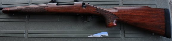

I refinished a Rem 700 stock many years ago, I used Tung oil and finer and finer grades of wet & dry, sanding the stock and using the sanding dust and tung oil to fill the pores.
It's been very waterproof and durable, oil finishes are so much better than plastic.

That Rem 700 was purchased new in the 90's and was refinished about a year after buying it, the photo was taken approx 20 years after refinishing it.
The time taken to refinish it didn't matter, no one was paying me and all I wanted was the best finish I could do at the time.
