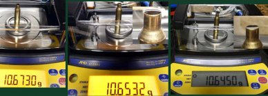

Here are some 6mm Hagar cases with a reversed spent primer.
Weights are in grams. Meniscus variation is 0.028 grams, or 0.431 grains.
Note the straight line reflection in the last case.
(Used 6bra1k tissue wick method :) )
I'll dry and redo this to see if I can repeat the measurement.
Notice the ever so slight negative meniscus.
Fairly repeatable :)
With the concave shape the actual weight of a full case is probably a milligram heavier than indicated or 10.6454g or so. The empty, with spent primer is 8.3442 grams. Water weight of a full case would be 35.512grains.
EDIT:
Did a slightly heavier case. Rounding to 3 decimal places (nearest 1mg)
First case was 8.344g empty, 10.645g full=2.301 cc (35.509 grains of water)
Next case was 8.584g empty, 10.860g full=2.276cc (35.1245 grains of water)
8.584-8.344=0.24 grams of brass difference, 2.301-2.276=0.025 grams of water difference.
Brass to water 9.6 to 1.
Sounds reasonable to me :)
