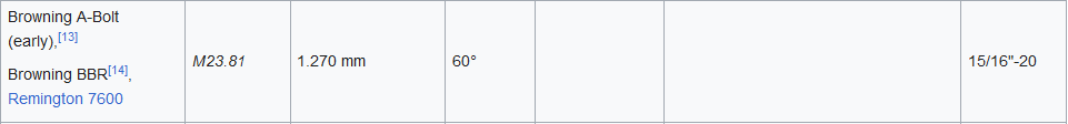

With all of this talk of interference thread fits in Stainless Steel Actions, my first thought is how the heck does Browning get the things together.

Jackie, Stan Ware had a little niche' market rebarreling the A-Bolts. Some had the threads beat up from the factory but most weren't. A bigger issue was tweaking the actions when removing the barrels conventionally. The factory barrel would be cut off about 1" ahead of the receiver, the reciever would go into a 5 gallon bucket of diesel fuel for a day or so and then he'd bore the old stub out. Most of the time, the threaded stub would just screw out by hand as the wall thickness was reduced during the boring process.

Jackie, Stan Ware had a little niche' market rebarreling the A-Bolts. Some had the threads beat up from the factory but most weren't. A bigger issue was tweaking the actions when removing the barrels conventionally. The factory barrel would be cut off about 1" ahead of the receiver, the reciever would go into a 5 gallon bucket of diesel fuel for a day or so and then he'd bore the old stub out. Most of the time, the the threaded stub would just screw out by hand as the wall thickness was reduced during the boring process.
