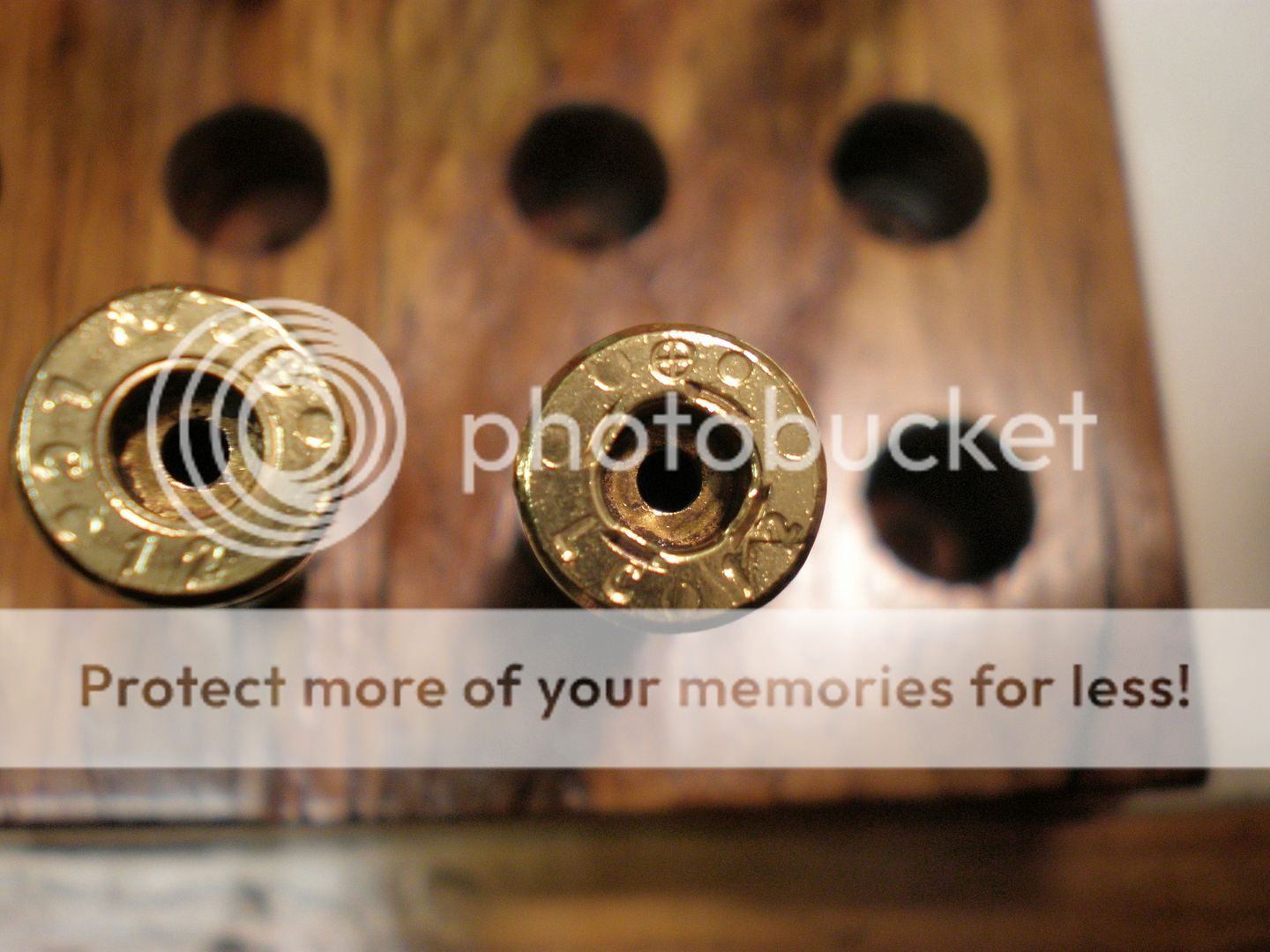

I have been having some issues with tight bolt closing on brass I know was resized for my gun and was trying to figure out what was going on. I made 40 rounds last night and all the brass was correctly sized but found almost half are too long for my chamber AFTER seating the primers. What do you do if the primers wont go deeper, ream the pockets? This is Federal .223 brass and using CCI 400 primers.
I usually just use a primer pocket uniformer to get my primer pockets to the correct depth each time I load, but on the other hand, I have friends, namely one in particular, that won't run a primer pocket unifomer into any of his brass under any circumstances, based on the thought process that there's "no blanking way" that he is going to get that anal about such nit picky details about his brass (one primer pocket depth being similar to all of the rest). I suspect that he's just smashing all of the primers to just under flush. Maybe I'm the fool here, I don't know.

That was my thinking too till I ran across this problem. I have the tools now and will make it a regular part of prepping the brass from now on.
That's a new one for me , I have never seen Remington .223 brass with crimped primers...
You will find crimped .223 primers in AR15 forums and people asking why the new primers don't fit in the primer pockets.

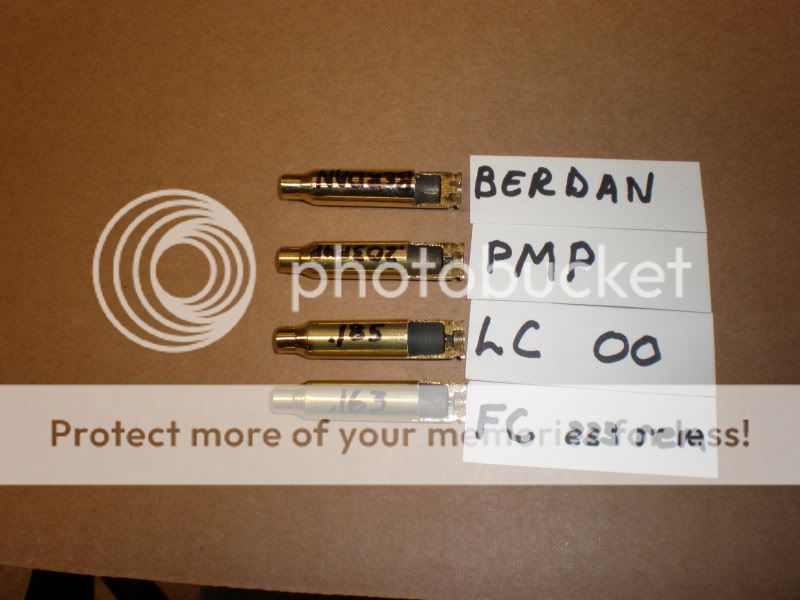

You do not need to section the .223/5.56 cases, just make a 2 inch rod and drill out the bottom to be cup shaped. This allows the inside end to fit over the flash hole and any burs and measure web thickness.
All the dimples on the base mean is which machine the cases were made on. I have read these type cases failed Lake City quality checks and Federal uses them for .223 ammo. The 2 inch rod will let you know how thick the flash hole web is. The thinner cases are not worth doing any case prep on because the primer pockets stretch out of shape after very few reloads.

The photos below came from ar15.com and the moderator dryflash3. There are many postings of his on checking methods and separating cases worth reloading. Unfortunately I prepped hundreds of Federal .223 cases before finding this information.

Some of the federal .223 marked brass is not as hard and has thinner flash hole webs.
The photo below also came from ar15.com. And is not "Contrary to popular beliefs".
And my 2 inch rod doesn't lie to me, nor do the photos I posted.
Again it is believed the cases at LC that do not pass quality check are used by Federal in their American Eagle ammo.
Below Lake City 2 inch rod measurement .185, and Federal at .163
