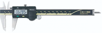

I use a primer pocket uniformer every time to ensure the pockets are all the same depth, then use my Mitutoyo digital caliber depth gage to verify all primers are .002" below flush.
Seems to have been working ok for many years, but am I missing something by not using a dedicated tool for this?

The difference in actual measurements between my caliper and dedicated tool is significant. Of course, that is me with my tools….
When I bought the Accuracy One primer tool, I was very surprised at the difference between measurements.
Maybe it was just me?

And when you get the RHP tool, you'll see another difference. It's the whole rabbit hole (pardon the pun) of 'trying to measure to 0.001" with a tool only accurate *to* 0.001" '... and no, just because some calipers show an extra '5' at the end of that doesn't mean they're actually reliably accurate to 5 tenths.

The reason for using a 0.0001" Mitutoyo digital indicator when we are really only with 0.001" adjustments on our primer seaters and primer pocket uniformers is so that we can see how close we really are to our actual 0.001" tolerance. All measuring instruments have a certain amount of error/inaccuracy, so choosing an instrument with less error than the tolerance desired is good practice for getting best results. It all really comes down to an individuals expectations on target; if your not trying to compete at a top notch level - then this is probably not for you. If all someone wants to do is shoot a deer at 100-200 yards, then don't even worry about any of this. But if you're a precision fanatic, then this tool is right up your alley and you will benefit from the use of it.
