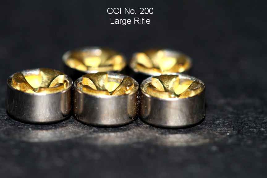

I went through this about 25 years ago and I just seat till the primer bottoms out and I hand prime and can tell by feel when a primer is bottomed out in the primer pocket. Below is an image of some CCI 200 large rifle primers. Looking close we can see the anvil sits just above the primer cup, all primers I have looked at up close and personal under magnification look this way.
Seating till I feel the primer bottom out normally results in about a 0.003" gap between primer and case head with the primer below case head. Figure the primer pocket has a depth and the primer cup has a height and both dimensions have a tolerance. I never noticed any difference in my group sizes dependent on primer seating depth.
