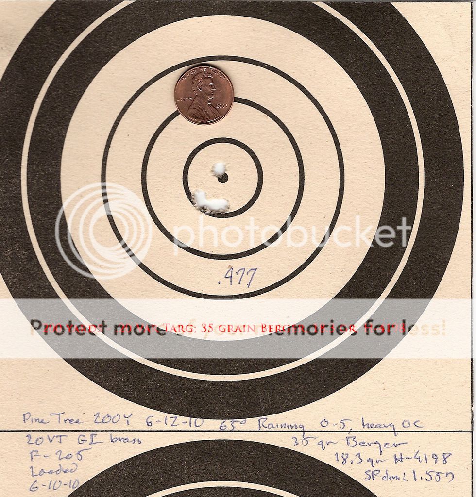

Thanks for that John, Im try to source some 35 bergers here with no luck. Ive tried the 32gn bergers with AR2207 (H4198) with some luck but cant replicate the 5 shot .179 with 17.1gn of powder i got. The gun is a tikka with 11 twist kreiger. I won't have the BR gun till after christmas I might try and find some of the 32 Hornady V-max and work up a load. Cheers mate.
This is my .20 Vartarg, I couldn't be happier with it.
This is a 5 shot group at 100 yds.
John
DAMN!!!..very nice rifle sir.
My 12 twist benchmark barreled Tikka with a 23" #5 contour barrel shoots almost the same load into 3/8" at 204 yards for 5 shots with 18.4 gr H 4198, 35 gr Berger and a federal 205m primer. Hoping I could learn about a new load. Lol
