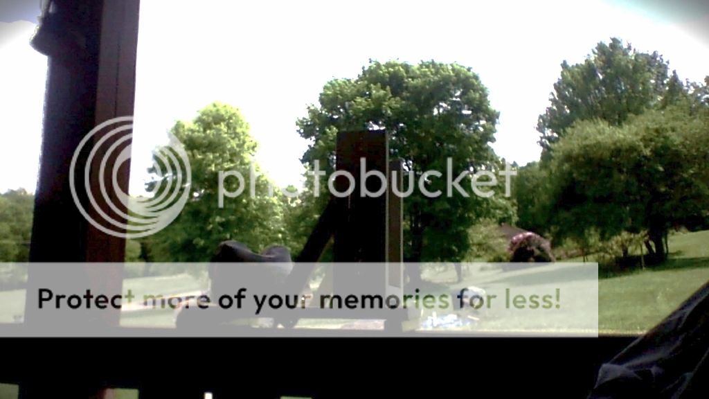

this year i was going to use the lead sled i just bought. i was using a 444 marlin in my encore that normally shot .6" at 100 yards. i took out the lead sled, sat the encore on top of it and started shooting. i went from .6" to all over the place!!! :(. i then took out my home made forearm and sandbag out. the 444 marlin was back on at .6" . i know that the lead sled works, i shoot my 30-40 krag with 165gr ranch dog out of it. must be a single shot kind of thing.
anyway, i use 41.5gr of superformance with the 75gr amax. i've got a picture of the home made thing, sorry the pic is so dark, its from my laptop. when i start shooting my 22-250ai this year, i'll try to get some pics, i don't have a cell phone or anything digital. dang stroke!!! ;D

i forgot to mention the front(don't know what the word is) bag supporting the gun just ahead of the frame rather than farther out on the forend. i learned this trick on anther forum. ;D
