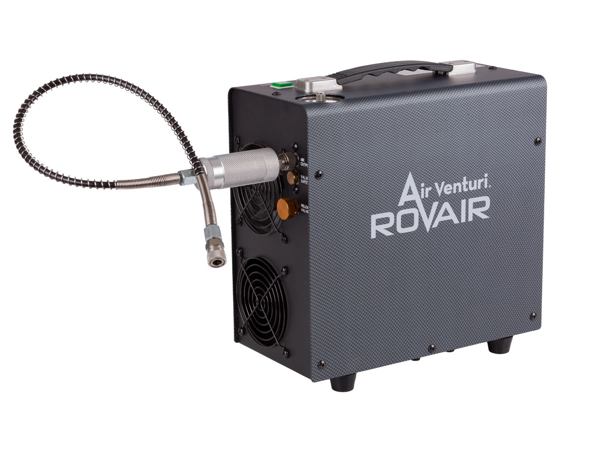

The hand pump I bought works well... but it's slow and takes some serious physical effort. Airguns of Arizona has a 75 lb carbon fiber Omega tank on sale for $530 (Omega 75 lb Tank) that I've been looking at. No idea how many full-power shots or bottle fills on my FX Impact M3 that translates to... but that's what I've been leaning towards. I have a paintball outfit within easy driving distance, so getting it filled shouldn't be a problem.
But this Rovair compressor linked by Dusty is slightly cheaper, and might work just as well, or better. Having both a tank and compressor would obviously be the best solution. But between the two, any opinions on which would be preferable?
There’s a guy in CA that sells tanks. Joe Broncatta or something like that. I think it is air tanks dot com. If u have a local dive shop they may have a used tank or even a rental.
I prefer to fill the gun from a bottle myself, no particular reason other than i feel its better control so i dont blow a rupture disk and less time its actually hooked up to the gun. Omega makes a very small bottle you can get if you dont want to spring for a big one to go along with your compressor.
