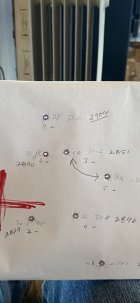

I shot a pressure ladder a while back with 4064, I wasn’t super impressed but I also only shot one round per increment.
Try something in the 29.5 - 30.2 gr. range with a 105 class bullet. My best results came from 30.1 gr., I went with 30.0 to keep it simple.
