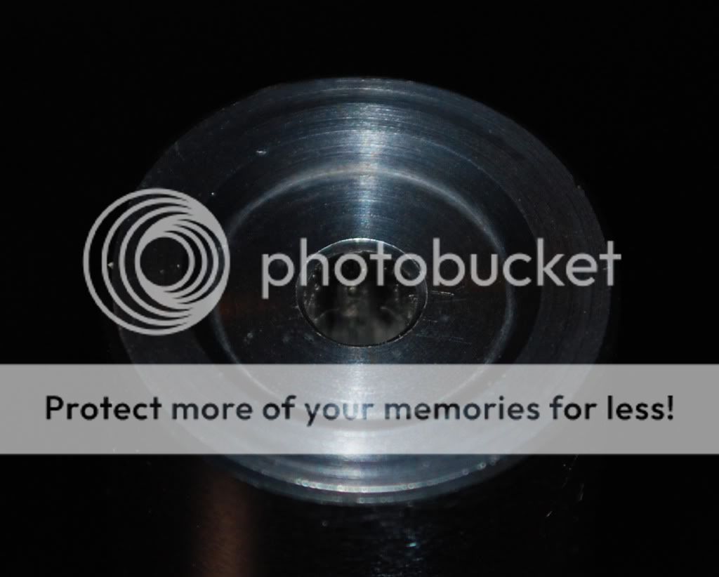

Siiri told me that Savage only said there was a problem with the chamber. Once Siiri brings her gun over I'll take a pic of the crown to show you. I will try to take a pic of mine to show you what is wrong with hers. Mine is blued so its harder to see, hers is stainless.
Thanks alot for everyones imput. Tons of awesome people on this forum.
I have a idea what you are talking about concerning the crown, savage recessed my .17 crown a little and it is cut straight. If it is the outer ring so to speak that is off center I dont think you have a mechanical problem only a cosmetic problem. But post the pics just the same please.
Wayne.
Here are the pics. I'm talkin about the part that is cut at about a 45* just around the bore.
On mine its the same all the way around. On hers its not even.

Yes if that part of your crown is cut uneven you probably will have accuracy problems. As long as it took her to get it back from savage the first time you might consider having a smith fix it out of pocket.

Both Siiris barrels are cut off center. And I guess that’s why her gun isn’t very accurate.

I am running through my options on what to do about my gun with the awful cut crown. :(
Siiri
The barrel should be easy to remove as I believe it is pinned.Just make sure you drive the pin from left side to right.Have it recrowned,it wont cost but 30.00 or so if the barrel is off.Send it to me and I will crown it for free as long as you pay the shipping.
It looks like the chamfer tool was off center. It is easily fixed.With all the troubles you guys are having ,how come I have no troubles with the 5 savage's I have.I think you got unlucky. It happens and I find it hard to believe that savage wont make it right.Maybe you need to talk to a supervisor.Alot of the people that handle these problems have never even held a gun much less shoot one.They are just reading off a menu of answers and I will bet that savage's pr people dont even no there is a problem.

To be honest, with the two photos, I don't see the problem. That said, I don't know why Savage is doing that 45 deg. cut. I would much prefer a straight cut, and no attempt to clean it up with a bevel.
Savage has been changing their rimfire barrel mount method, and I am not up to date. I understand some of their recent barrels are threaded. However, the older ones, and the one I have is a press fit, and a pin. They are quite ugly to replace. The threaded one would be easier, but in the end it would probably cost you more than a new gun.
It would be much cheaper to have a re-crown done. Check the Gunsmithing section of the forums here. Matti has posted a question there about doing the re-crown. There are good ways, and very bad ones.
