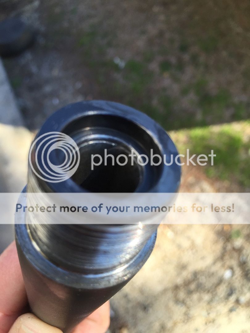

It looks like a cold chisel got in this chamber
The last new R700 SPS I bought was about 5 years ago. It would not chamber a factory round of 223 when I got it home and cleaned up. Turns out, via the borescope, the chamber had a deep gouge in one place and the metal was pushed up into a "pile" next to it. Obviously they don't do even a one shot test fire before they leave the factory. The worst part was they forced me to take it to an Authorized Warranty station even when I told them no one but the factory could fix it. The "Warranty station" wound up shipping it back and they charged me $40. Screw the whole bunch!
