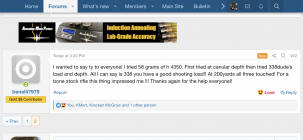

^^^^^^Two years ago I started hand loading for my Winchester model 70 3006. my second load up the ladder I shot a five shot group Cloverleaf at 100 yards and never moved my scope it was already zeroed I never chronographed the load because it was so good and I’ve been using it ever since. on a sidenote I’ve put this out on two different forums and several people responded back saying the load was amazing in there rifle as well
