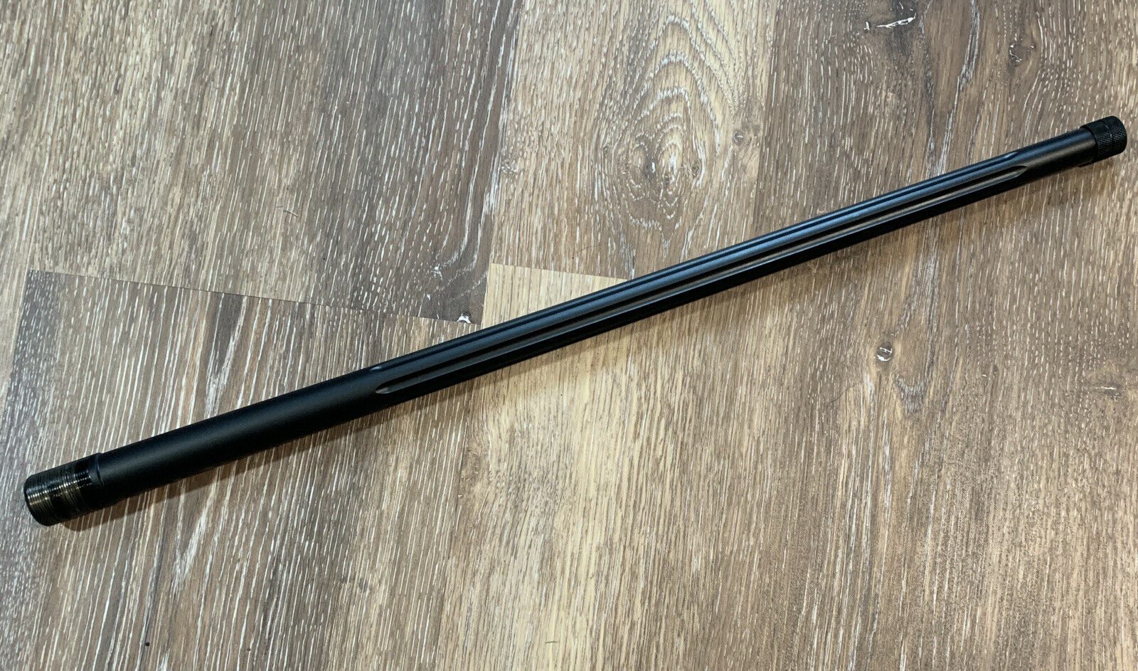

So a little update, I found a savage 111 barrel, but with the extran length of the bolt and needing to rechamber, I decided to rechamber it for 243 AI, however now am needing the rear bolt cam. Anyone have any insight as to where I could find something that would fit?
I think yours would be a flat rear action. Numrich might have the rear baffle.
