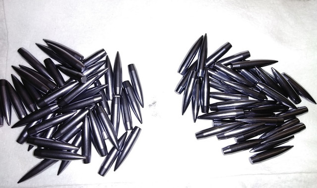

You might have a run for your money, urbanrifleman. Wet moly coated 100 6.5 bullets and boy do they look shinny. My dry method still looks really good, but not quite as well as the wet moly. Thanks for starting this thread otherwise I might have never known about it.
Dry on the left and wet on the right.
