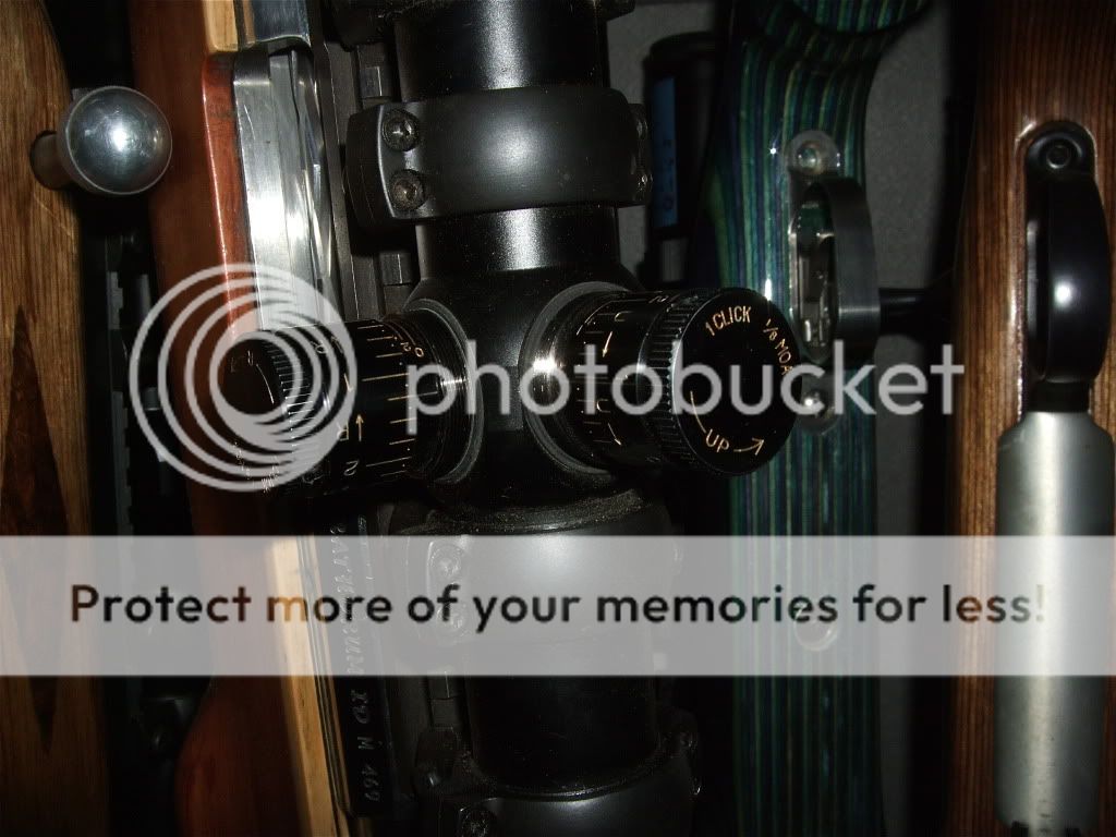

I looked through a NXF model today. A guy had one that was a 22x and had a MLR retical. I kind of liked it but wasnt my favorite. I am wondering if someone could take a picture of the target knob of a benchrest model for me. If its not too much to ask. Ive been looking around but cant find a picture anywhere. I want a knob that I can dial from 100-1000 with out getting lost. The scope I have now is a T36. The rotation lines are way too close. This makes it hard to dial and not get lost. If someone could post a picture, it would make me decide one way or another one which model to get. Thanks a ton.
NXS scopes can be purchased with either 1/8 MOA clicks or 1/4 MOA clicks. The Benchrest models all have 1/8 MOA clicks. If you do not like lines close together, you should probably get a 1/4 MOA NXS. My BAT F-Open rifle has an 1/8 MOA NXS. The finer clicks are useful as it is <1/4 MOA from center to the edge of the X-ring.
Here ya go Josh, if you need it different just ask..

Josh,
My BR models have 6 MOA per roatation with 1/8 MOA clicks. My NXS models have 10 MOA per rotation with 1/4 MOA clicks. I don't have any high speed turret models but I believe that will give you 20 MOA on a revolution. I don't know if you can get the high speed turret with 1/8MOA clicks. You are still going to have to pay attention to where the standard knob is going from 100 to 1000 as you will have a few turns on it.
