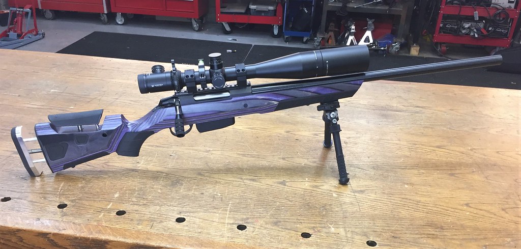

Newest addition... Tikka T3x .223....
That's how my stock thread started. I liked the Tikkas but hated the stock. Some one let me shoot a Master Sporter. I loved it. I bought a few, but they're EXPENSIVE!! I studied the stock for a while and decided to take a shot at making one, with a few minor improvements. Once I made a few, I figured I'd share the process.

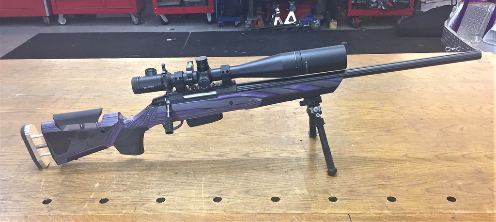

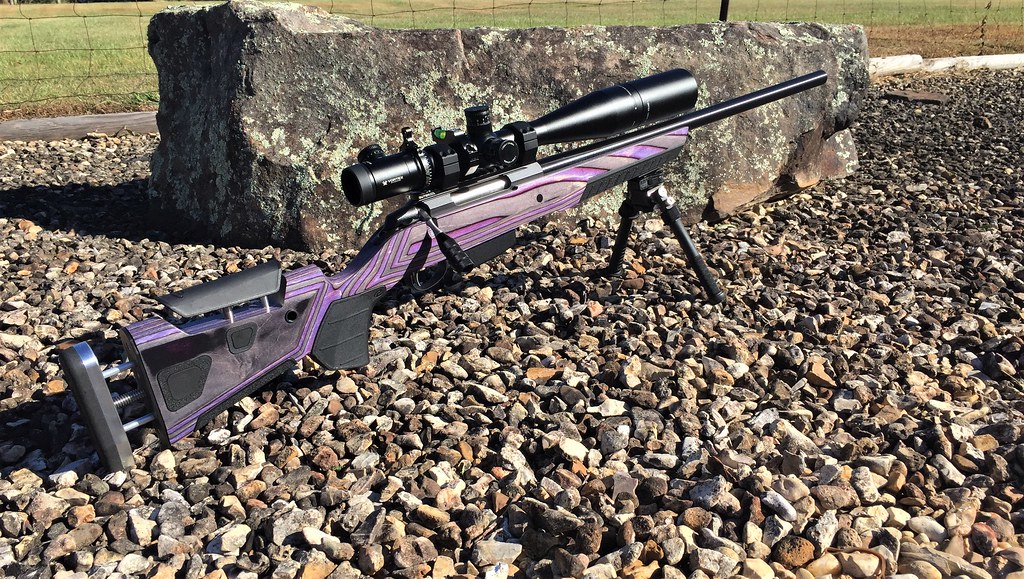

The AT One landed today. I got everything changed over tonight and I quite like it. Was holding my breath when I saw the box on my porch though. UPS was not very kind to it.
Amazingly enough, the stock was just fine.

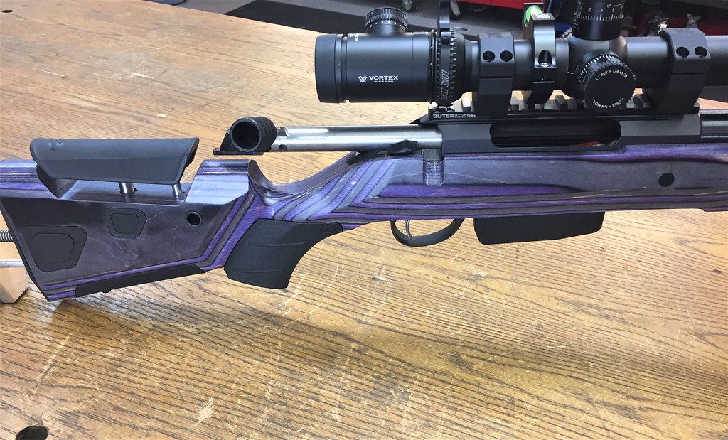

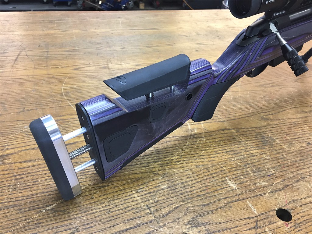

Push button stock adjustments work well. The adjustable cheek riser and LOP are the main reasons I got this stock in the first place.

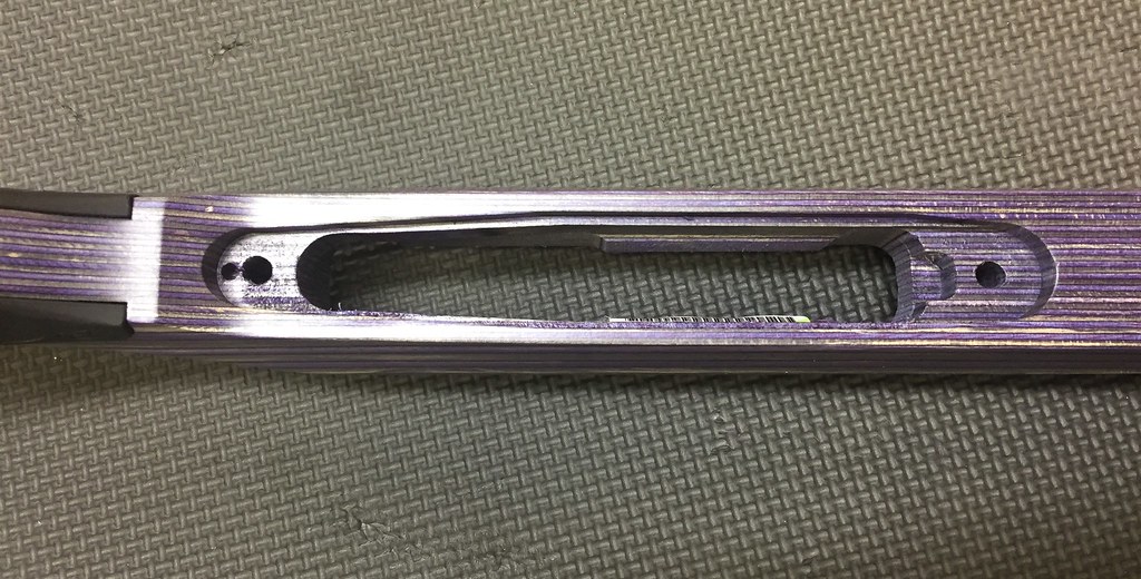

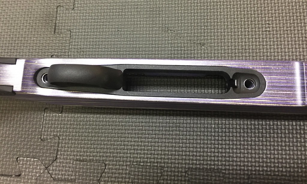

Checking out the mill work reveals that it is very well done. The factory bottom metal ...er...plastic fits very well. I have Atlasworx bottom metal ordered but it's on the slow boat so not sure when it will be here.

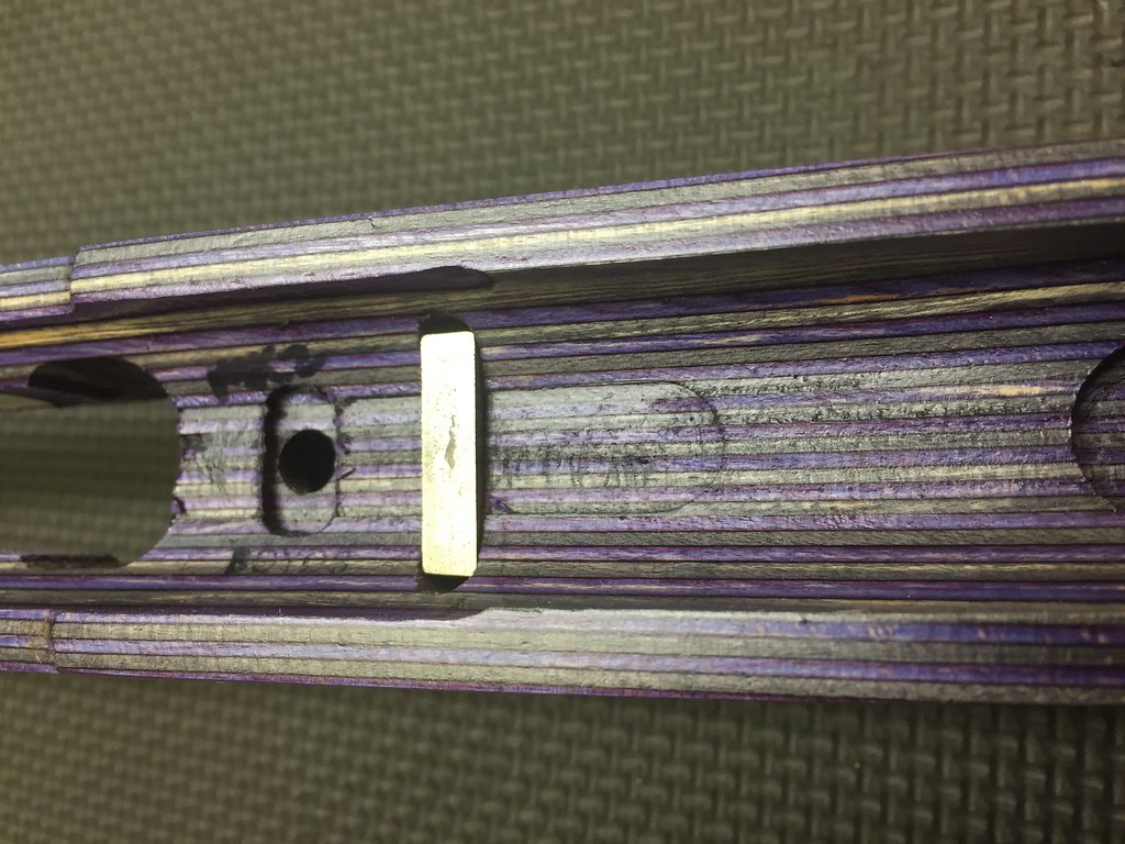

Very snug fit on the steel recoil lug and the action fits the mill work perfectly.
Free float on the barrel passes the dollar bill test with flying colors.

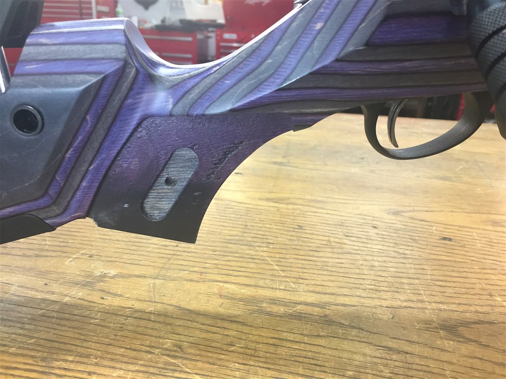

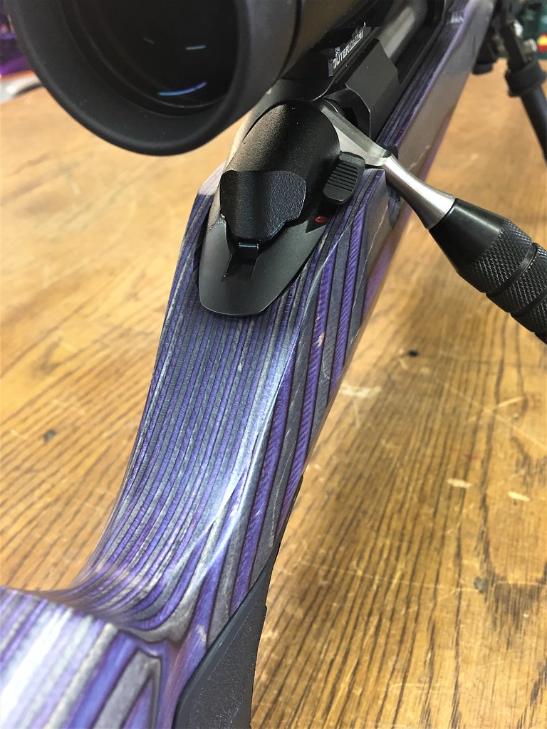

There are some nice touches like this little milled recess for your finger at the bolt release.
Overall I am very well pleased. Can't see how one can go wrong for $200 shipped.
What is the weight difference? Looks very, very nice!
I didn't weigh them separately but the Boyd's is heavier than the original. Very nice balance. I added 1 lb to the butt on the original to achieve the same balance as it has with the Boyd's.

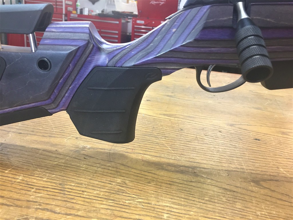

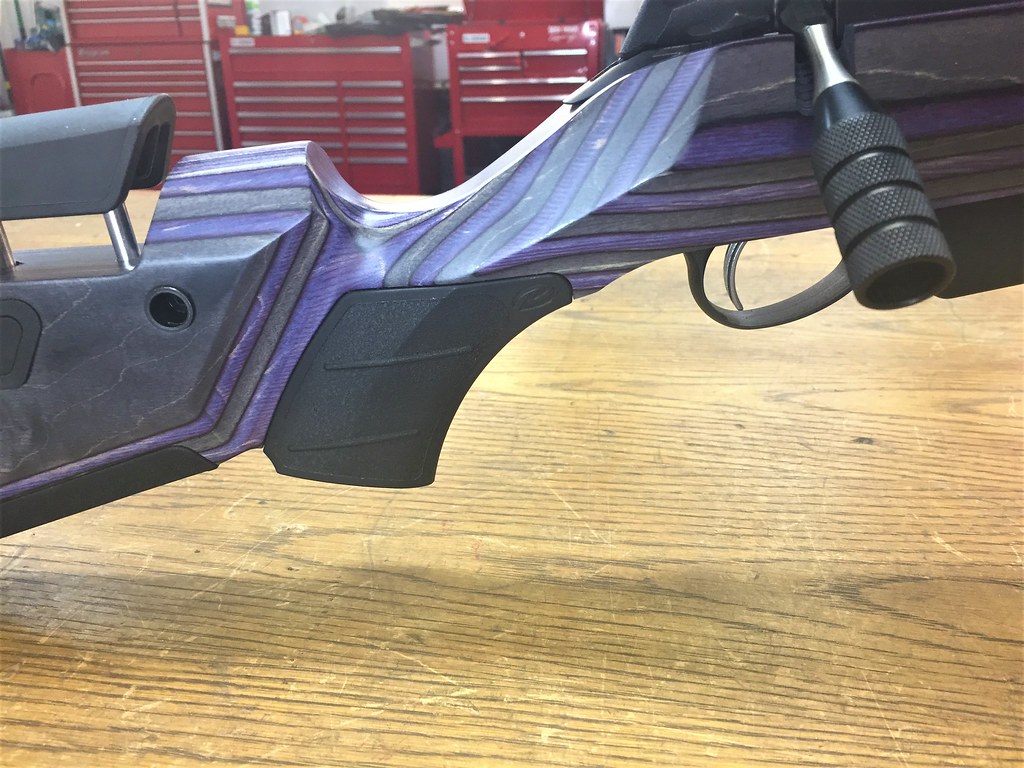

Got the target grips today. Basically they are fatter and more vertical. I like the feel of it. Guess we will see how it goes once I can actually shoot it.
The original...
The grips have a boss made into each that locks into a milled recess in the stock. A single screw goes through the grip, the stock and into the other side grip to secure them.
And the target grips...
The original stock weighs 2 lbs. The Boyd's is 3 lbs. The bulk of the weight in the Boyd's is towards the butt which is exactly what the rifle needed. It was very muzzle heavy with the original that's why I added the 1 lb. block of duct seal to the butt. That balanced it out well with the center point just ahead of the magazine. Same exact balance point with the Boyd's.
