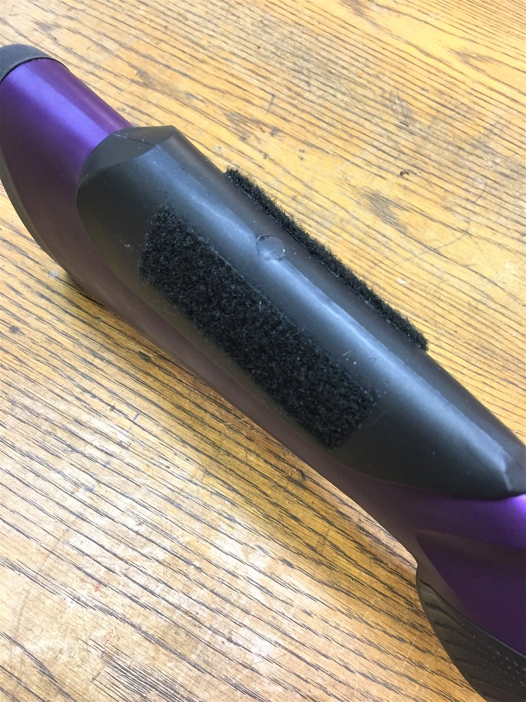

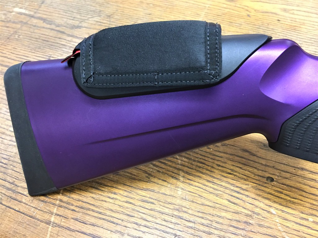

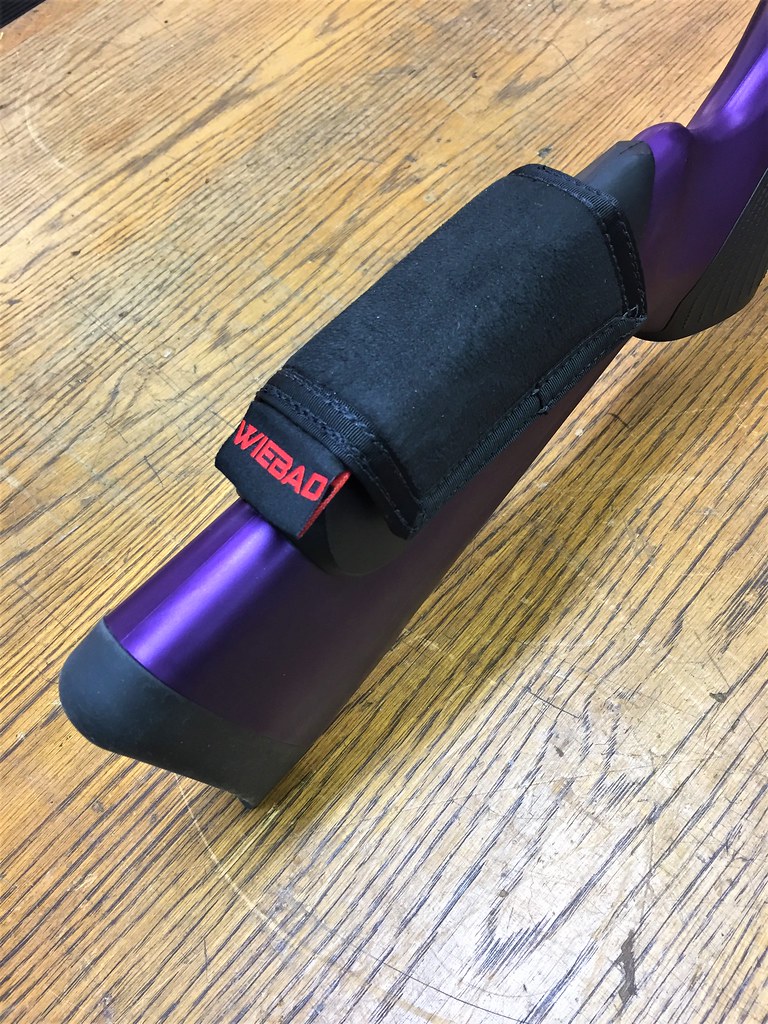

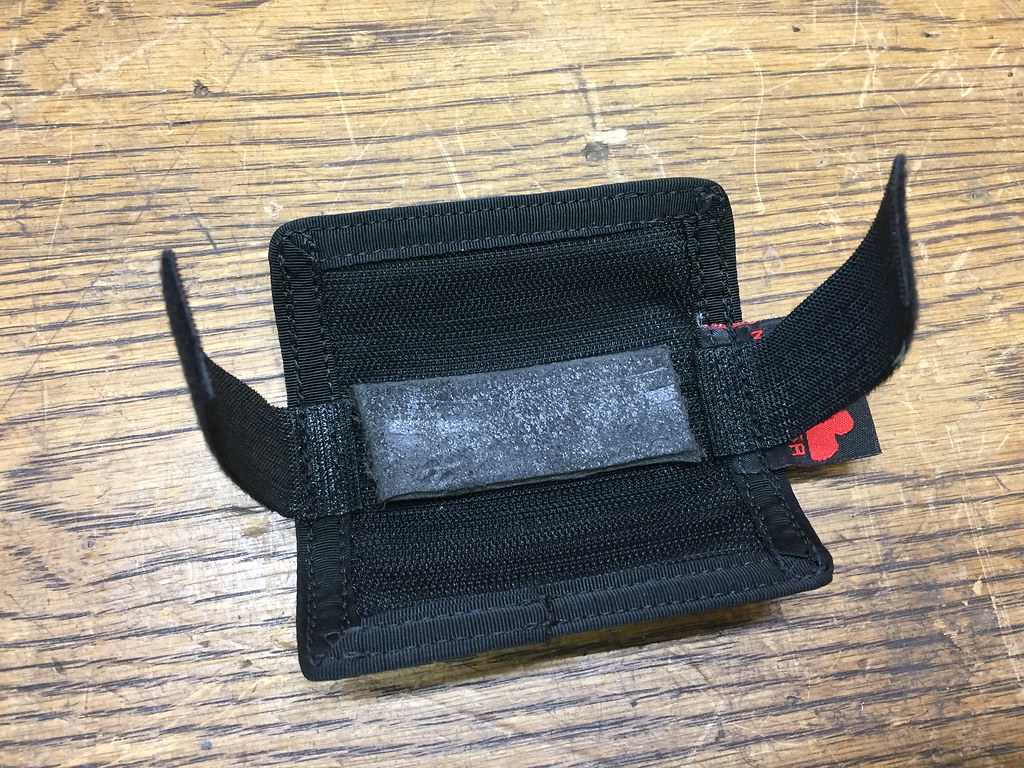

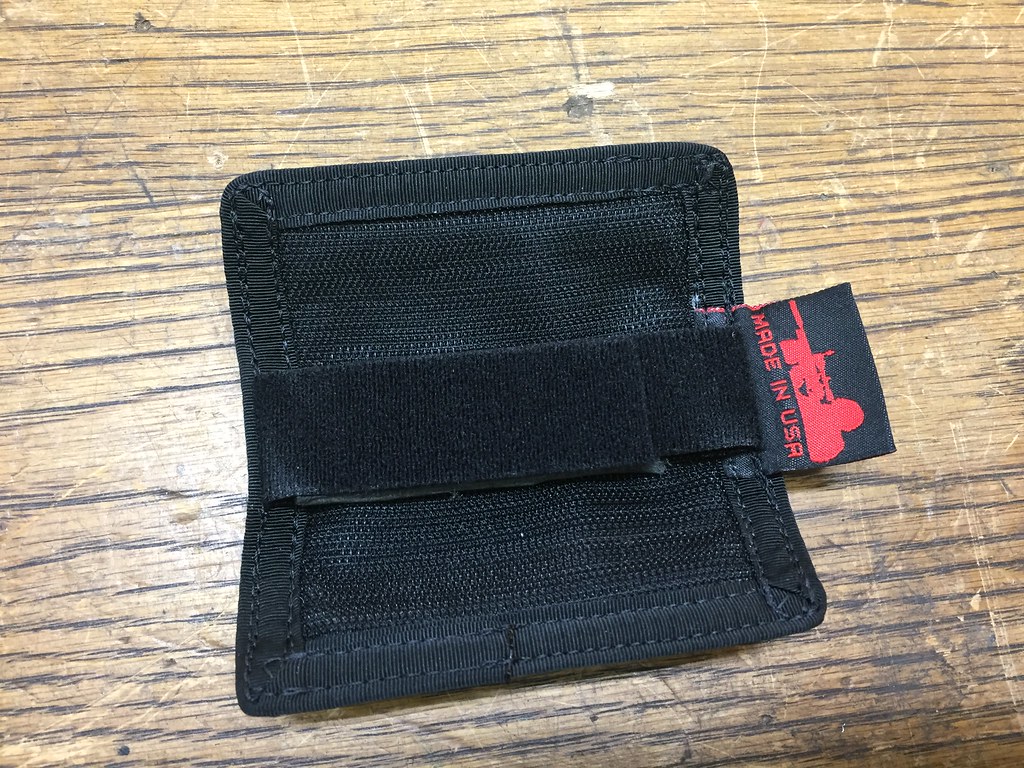

Apparently necessity is still the mother of invention. It came to mind that I might be able to repurpose the Wiebad cheek pad from my RPR to solve this issue. I have RPR stocks on other rifles so l have multiple cheek pads. Attached a couple pieces of industrial Velcro to the existing cheek rest. Added a piece of leather from an old belt for a spacer. Secured the leather with the strap that was supposed to go under the RPR cheek rest. Worked perfectly. I have that perfect "just lay your head on the stock and open your eyes to the perfect sight picture" fit now. Don't think it looks too bad either. Now to make a spacer to lengthen the LOP a bit.

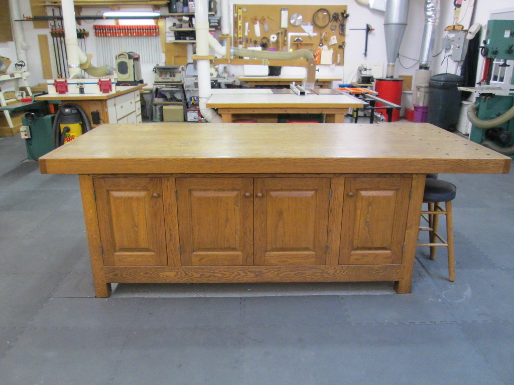

Thanks Josh! I love wood working also. Have built furniture and such for many years I'm blessed to have a pretty nice home shop for wood, metal etc...
Hey. That is a nice shop!It's almost too clean! Great dust collection system. Looks like you have all the tools needed. PM me with your address if you want a pattern.

Thanks for sharing the duct seal idea as I am headed to lowes to get some for one of mine that I dont want permanantly weighted or altered. That rifle looks bitchin in that color. Great job.
Thanks! The duct seal was one of those Eureka moments. Seems a much better answer than lead shot.
