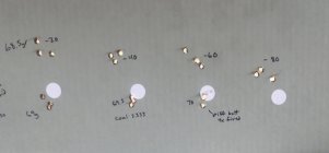

My two cents.....
I shot the following groups this week.
Top line is seating depth.
They don't drastically change but -40 seems smallest. I do NOT like how -80 impacts lower.
Bottom line is powder charge. I DO like how the impacts are all in same position compared to sticker. 69.5 seems to be smallest.
These are only at 100 yards. They need to be verified.
You need to be very confident in your shooting and set up to get much information from my targets..... are you a naturally 0.25-0.5-1 moa shooter? I'm about a 0.3 most of the time on hunting rifles.
