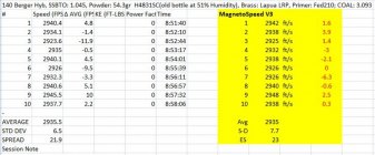

When I first got my Garmin, the very first time out on the range I had my MangnetoSpeed mounted to compare recorded velocities. . . .and there was a couple other shooters next to me using their LabRadars where I just set my Garmin down next to them for a comparison. Where you set down the radar type chorono's makes a difference. See the numbers in the pics below:
