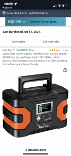

I wish this was not true but know that it is. Hence, got to figure out a safe way to transport and set up and use the fx120i mobile. @BartsBullets has a real fancy box that he built. What are the rest of you using?

This is what you need 120i A&D with a V4 Autotrickler. I can get you a box made and order a Flash Fish portable battery. I’ll have you loading at the range in no time.
Bart
