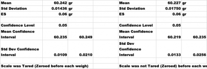

This article is very good at tying the accuracy of the scale to the on target performance. It is actually a little generous about the performance of the 120i. Unfortunately the AnD manual specifies a repeatability of 0.001g which is .0154gn. This is a one standard deviation value. Additionally the scale resolution is 0.02gn. The linearity is +/- 0.002g or .0308gn which is a bias error which can be ignored if we are only using that one scale. In terms of precision/repeatability of the scale for comparison to accuracy (95%)of the Chargemaster the 120i is (2xSD)) + resolution or 2x.0154+.02 which is 0.0508gn or about 1/2 the repeatability/accuracy of the Chargemaster which is limited not by the electronics but the display resolution.
I am not dumping on the Fx-120i just clarifying its capability. Its weighing technology is superior to lower end scales and it is obviously more accurate.
The Chargemaster is a compromise solution to powder dispensing. The single dump tube doesn't handle the trickling job well. It tends to drop varying amounts of powder and this leads to both under and over charges and also to lighter or heavier charges when a large clump dumps and the scale reads the weight too quickly. This is due to hysteresis of the scale and the software timing. The 1500 with the software mods and straw modification can do quite well. The Supreme has the software internally to adjust the speed. My 1500 can do the following:
This is for 28 charges of 8208XBR. The reference scale is a Gem 20. Its performance is:
Test was 20 weights of a 60gn NBT bullet. That test also shows the improvement in the SD due to taring the scale before each weighing. This eliminates the scale drift that is undetectable when less than the scale resolution.
