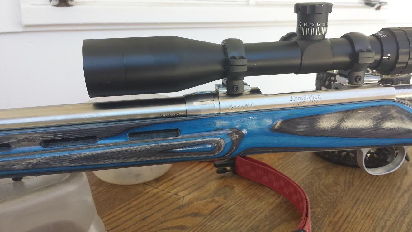

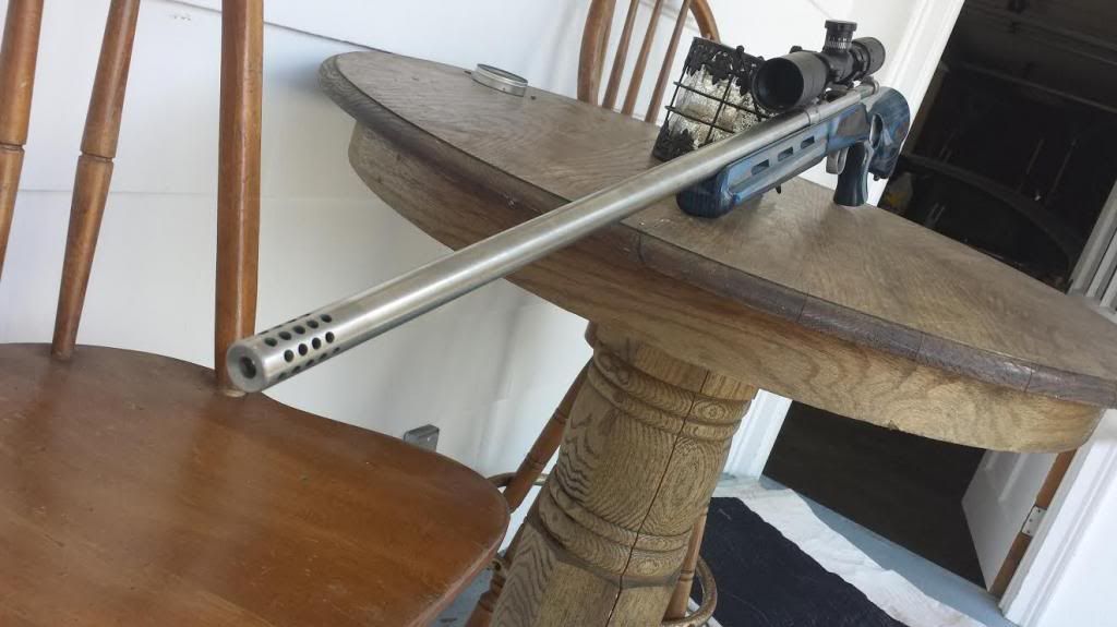

Here is one of mine it was a 300Rum Sendero and now it is a 338 Edge with a 32" Barrel, actually I have 3 barrels for this setup a 358Rum and a 375Rum all 32" barrels that I swap back and forth. It takes 10 min to do the swap ready to fire head space and all, I have even done it at the range just to see if I could. It is more than a hunting Rig I can hang with the 1000 yard crowd and be competitive, my favorate varmint load is 160gr Barnes TTSX's with 105gr RL17 for 4200fps+ I acually shot that load at 1000 yards for poops and giggles there was less than 15 moa of drop.LOL
Dean
I also have a few on the smaller end as far as case capacity, my VSSF 22-250 has 4 Barrels 8,10,12 and 14 twist barrels that are all Ackley Improved, all work well and are extremely accurate. when I remove the factory shouldered barrel from a Remington action, what I end up doing is setting it back or "Rethroating" it, I always knock the shoulder off the barrel and put a barrel nut on it when other shooters see the Remington stamping on the barrel with a barrel nut they always leave scratching there heads.LOL
